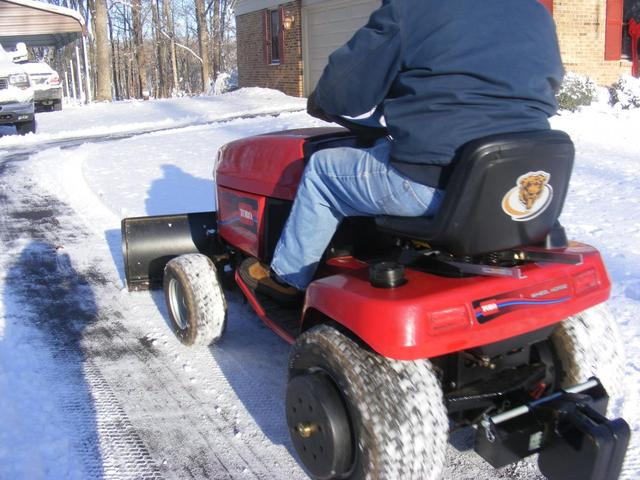

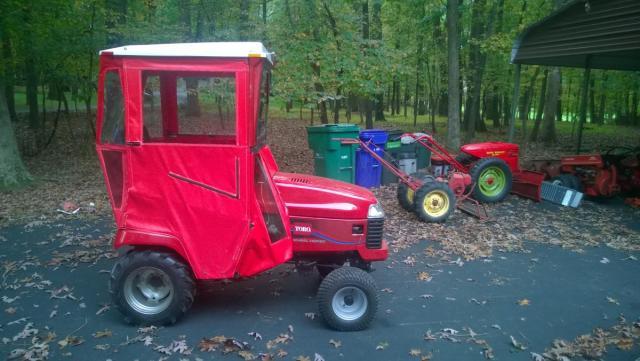

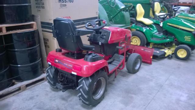

shallowwatersailor 3,213 #4 Posted October 15, 2014 (edited) The 520Lxi is a completely different tractor than your father's 520-H. Just to put it in perspective, this past summer I bought my third 5xi. It is a 1998 523Dxi diesel that had 605 hours and came with a 52" mower deck, snowplow, a pristine cab that maybe had been used once, two extra pair of ags, clevis hitch, a Brinly disc harrow, and a rear drag plow. Red tractors sell well at "green" dealers - because they're already ripe! All of this for $3K. Here is a picture from when I was buying it and another now getting ready for winter. It is getting the snowthrower that I have plus my new JB sleeve hitch with the drag plow. The snowplow is on the 520xi. The 520Lxi is the one model that I have not had any direct experience with. There is a series on YouTube showing one being rebuilt. The Kawasaki engine had a history with a plastic cam gear. I would suggest researching that on this forum, and others, to see if this particular tractor would be affected. With the water-cooled engine it would not have the issues of an air-cooled engine but would have its own with the radiator, waterpump, etc. The Kawasaki is light on torque compared to the 522xi with the Kohler Command but should be able to spin the two-stage snowthrower. The platform with the cab is much more roomy than the classic Wheel Horse. And power steering is nice. Look for any oil leaks on the transaxle. The left axle seal and return hose by the filter are known for possibly leaking. The plastic lower valance is a cosmetic issue (my 520xi's is broken) as it breaks when someone bumps into something. Red paint fades more than any other but you should be able to polish it back. I would think somewhere around $2,500 - $2,700 would be a fair price. Good Luck! Edited October 15, 2014 by shallowwatersailor Share this post Link to post Share on other sites

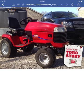

redtractorfan 13 #10 Posted October 17, 2014 I'll tell you that I own a 520Lxi with a few attachments and I wouldn't trade it for the world. If anything, I would buy another one if I find one to pop up around my area. My 520Lxi is the one that was rebuilt on YouTube and it is imaged on Toro's Facebook pictures. It is such a powerful machine runs so smoothly. It was probably one of the best Wheel Horse tractors built in my opinion. My dad owns one of the 1991 416s and there is no comparison. The ride, quietness, and sure performance is second to none in this series. Hope you can grab one up! Here is an image of my 520 Lxi from the Toro Facebook page... 1 Share this post Link to post Share on other sites
