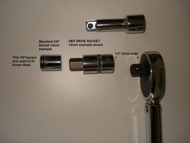

Just something to consider. You may already have what you need to torque the 3/8" Square Head Screws/Bolts in your Tool Boxes. I'm sure someone must do the same.
If you have a Male Hex drive Socket of reasonable size you can use this set up-
post-3520-0-10063900-1429006242_thumb.jp
Works well for me, saves buying another Socket and it's a square (4 point) socket = less burring risk.
Only drawback is retaining the final 3/8" drive socket on the Hex drive end as it's not magnetic.
I just use a piece of clear plastic bag over the hex drive end a push the final socket on to hold it there.
