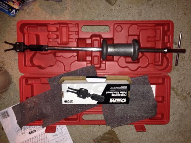

DISISIT13
Used this bad boy. The bearing puller was a little smaller so I had to jam it out of the center of the bearing with my hand to get it to stay in there. It took quite a bit of effort with the slide hammer. post-13964-142263235731_thumb.jpg
