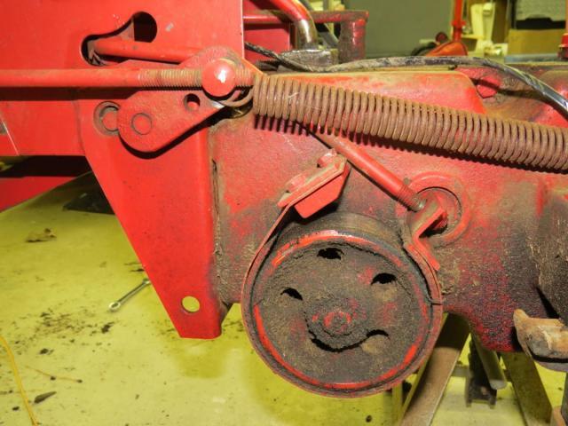

rustykan 140 #1 Posted September 26, 2014 Can anyone tell me if this is the proper placement for the clutch spring? Is it supposed to be attached to the clutch rod bolt or the hole below the rod? Share this post Link to post Share on other sites
Racinbob 11,386 #2 Posted September 26, 2014 That looks correct rusty. Share this post Link to post Share on other sites
rmaynard 15,767 #3 Posted September 27, 2014 It connects to the small hole below the trunnion. Share this post Link to post Share on other sites
Racinbob 11,386 #4 Posted September 27, 2014 (edited) I should have clarified myself. There's a small hole that can't be seen in the picture. It looks like it's hooked to that by the paint wear that can be seen. It doesn't go in the larger hole that's visible. Edited September 27, 2014 by Racinbob 1 Share this post Link to post Share on other sites
