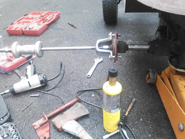

Docwheelhorse 2,992 #1 Posted September 21, 2014 Okay... so several months back I traded Sparky for a C100 8 Speed. It Ran and Drove but had a hub which had slipped in almost to the trans case... it was tight but just was one of those things that annoyed me everytime I saw it. Today I decide to TRY and FIX IT, this was after already asking Sparky if he had tried (Answer was yes....), and after noticing a piece of the hub broken off... so somebody else had tried too. But did I leave it alone----NOPE, CAPTAIN DUMAZZ grabs his tools and torch and is gonna teach this hub a lesson on whose boss. I setup my slide hammer---FOR ALL YOU OUT THERE DON'T USE A SLIDE HAMMER USE A PULLER... THIS WAS MY FATAL MISTAKE. I start heating the hub cherry red and start whacking away... hub moves and I get excited... keep heating and banging away. Then...... and the picture tells the rest. I'm an idiot and am posting this as a public service announcement... now instead of running the tractor with the hub slid in I get to roll it in the corner till I can either swap the trans or pull it apart. YAYYYYYYYYYYYYYYYYYYYYYYYY I'm So Smart!!!!!!!!!!!!!!!!!!!!!!!!!!!!! Tony "docwheelhorse" 4 Share this post Link to post Share on other sites

stevasaurus 23,808 #4 Posted September 21, 2014 (edited) Tony, you are looking at this thing all wrong. It is a blessing in disguise. Now you can attack that axle and hub directly...the easy way. Sure, you have to split the trans to put the "C" clip back on the axle, but you can clean out the trans and change the seals and know what you have inside. Piece of cake and a silver lining in that cloud. Edited September 21, 2014 by stevasaurus 4 Share this post Link to post Share on other sites

squonk 47,927 #7 Posted September 21, 2014 That's not to bad. Try that on a cheapie lawn tractor and you have to take the trans apart and deal with a trans packed full of that nasty bennonite grease! Share this post Link to post Share on other sites

meadowfield 3,175 #12 Posted September 21, 2014 (edited) Tony, you are looking at this thing all wrong. It is a blessing in disguise. Now you can attack that axle and hub directly...the easy way. Sure, you have to split the trans to put the "C" clip back on the axle, but you can clean out the trans and change the seals and know what you have inside. Piece of cake and a silver lining in that cloud. I'm with Steve, just go for it and split the trans. It's a good opportunity to fix/replace any worn bits... You may well find the axle is chewed and needs swapping anyway. Also there's some funky guides to tranny rebuild on here Steve knows all about them :lol: Edited September 21, 2014 by meadowfield 2 Share this post Link to post Share on other sites

oldredrider 2,553 #14 Posted September 21, 2014 Tony, now that you've got it this far, set the hub where it needs to be with a hydraulic press. Then just slide the axle back in. All fixed....except ALWAYS remember you can only make right hand turns! Share this post Link to post Share on other sites
