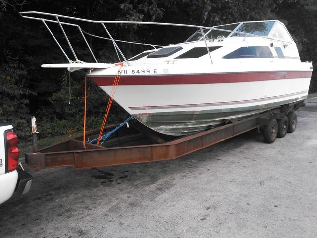

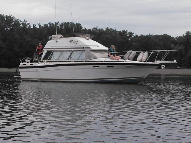

Heres a pic of my Bayliner with my kids on board in Wethersfield Cove and another of the Bayliner I'm putting together on the trailer....

Your boat is real nice Tony. You have a real solid plan and it seems you have been doing this for quite some time. Where do you go mostly? CT river?
