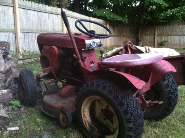

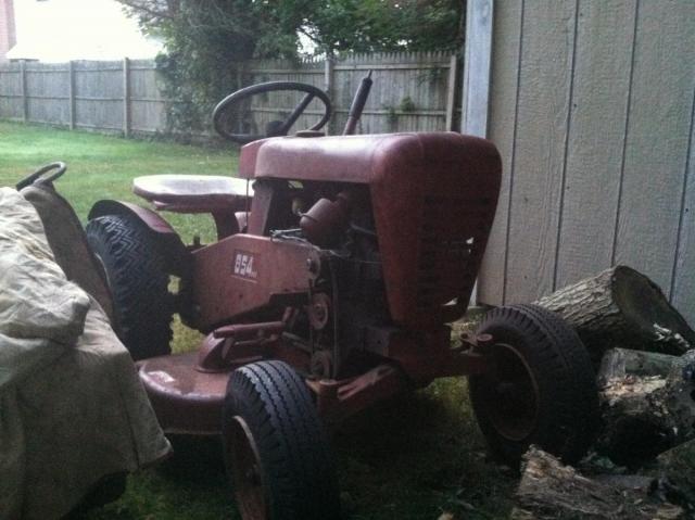

Hello. I am new to the site. I just picked up (for free!) a Wheel Horse 854 that I plan on making a project for the winter. The owner got it with the house 25 years ago from its original owner (so he says. Then again, if he's giving it up for free I see no reason for him to lie...).
He said he threw a little oil in the head and gas in the tank the morning I picked it up, threw a battery charger on it and it turned over. He suggested that I drain the current oil, throw some kerosene in and crank it over a few times to clean out the gunk. Then throw some lightweight oil in and run it for a few minutes, then drain that oil and top it off with heavyweight oil. He also suggested I clean the gas tank with toilet bowl cleaner before I add gas.
I will need to paint it to stop it from rusting in spots. It needs new rear tires (and probably fronts) because they are dry-rotted. There is some crud down on the frame under the engine.

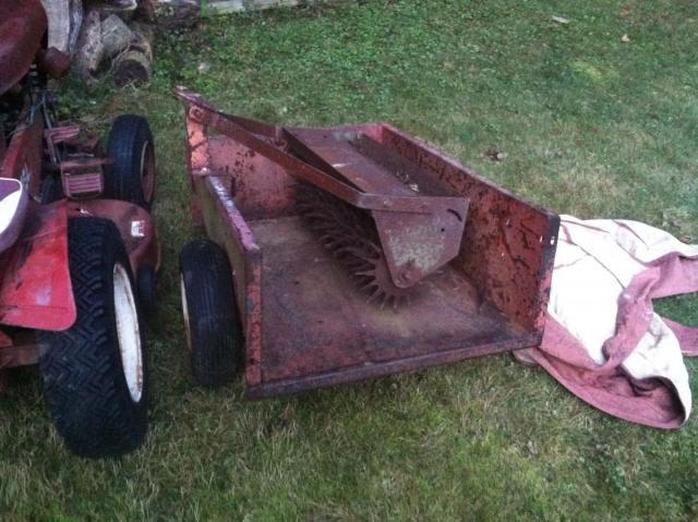

It looks to me that it is all original. It came with a cart and an aerator.
I took some pics this morning before I left for work. Friday night my four year old and I will start dismantling the parts I need to paint.

Hello and :WRS:
That is like the massive score!   :text-+1:    :text-+1:
JERSEYHAWG /  Glenn
Nice pick up, a horse with a few extras,,,,, best of luck.
And of course,,,,,, a big wellcome to red square.
Glenn
Molon_Labe
:WRS: That will make a great project. Keep posting pictures of your progress, we love pictures!!
Racinbob
Welcome to the forum. That's a dandy. The 854 is probably my favorite model. Looking forward to seeing this one saved :handgestures-thumbupright:
Carpenter
Cool tractor! It will be nice to see it have a second chance. Good luck!
Another really nice :wh: score...   :eusa-think:
interesting to note...how all these early carts, all of a sudden, start coming out of the wood work.
Catmanii
You can't beat free. Will be a really nice tractor with a little love and that cart will be really nice with a little cleaning and some red paint.  :)
Ed Kennell
Hey Wake :WRS: . You may want to think about changing your user name to LUCKY.  What-a-score and  at a pretty good price.
Geno
:text-yeahthat:    LUCKY   :laughing-rolling:  :laughing-rolling:   :text-goodpost:
Wayne
:WRS:  good find :)
KC9KAS
:WRS:  Nice 854!
I have it's little brother.....a 654!

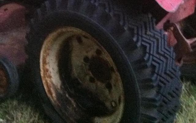

This morning I went outside to daydream and make a battle plan for the dismantle tonight, and I noticed that there is oil on the wheel.
post-13915-0-25982300-1411125521_thumb.j
It appears this is from the transmission. It has been sitting for a few years (according to the guy I picked it up from) so I assume it has been tilted on the flat tire. Is this a good indicator that the transmission needs to be rebuilt (or at least re-gasketed)?

Probably just needs axle seals, not a big deal to replace. Pulling the hubs is another thing, some slide right off and others, well, there are volumes of tales posted here on the woes of pulling hubs. You'll git 'er done.
Racinbob
I'm thinking you should drain and flush the transmission and get some fresh lube in there. Unless the case gasket is leaking there's no need to open it up if you find it's working properly. That oil that leaked could be a blessing when you remove the hubs. :)

There is a pipe plug on the very bottom of the Uni-drive for draining the unit. If the tractor runs, it helps in draining if the gear oil is warmed up - if not, it just takes longer.
Take note of what comes out - the oil may very well be contaminated with water and look milky - worst case is that there is standing water in it and you would want to split the case to check for damaged internal parts. If it is just discolored or milky, you need to flush it before refilling it. I have had good success using a 50-50 mix of Marvel Mystery Oil & new motor oil for a flush. You do need to spin the internals with the flush mix inside - drive it slowly for a few minutes or tow it behind another tractor - the idea is to get the mix to all the internals.
Getting the mix inside  - there is a second pipe plug at an angle on the lower left side for filling, but I find it easier to remove the shifter & boot in neutral & add the mix in that opening using a funnel - that will give you a small view of how nasty the inside is.
Allow the mix to drain, repeat as necessary until it shows no water. Fill with GL-5 rated 85W-90 or 90W-140 gear oil - yours takes 1 and a quarter quarts if I recall - use the side plug as a sight plug - remove it & fill until it flows out.
One more note - check the frame plate at the 4 screw holes where the Uni-drive bolts on for distortion damage & cracks - I've got 2 854's - both were damaged (but fixable).

I'll add one thing to that and suggest that you hoist up the front  when you're draining. There's a hump inside that will trap some of the fluid.
