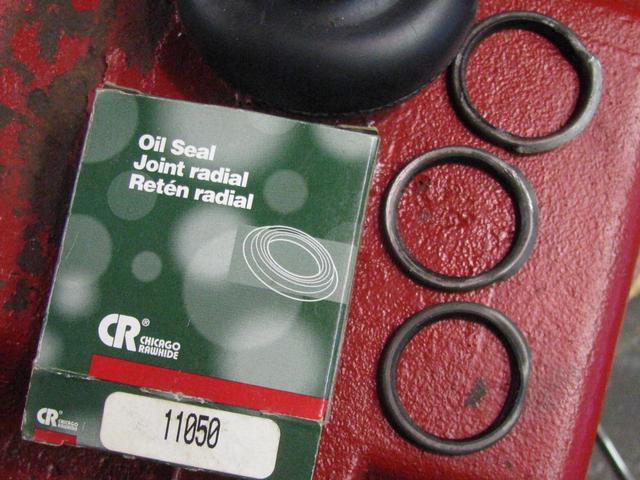

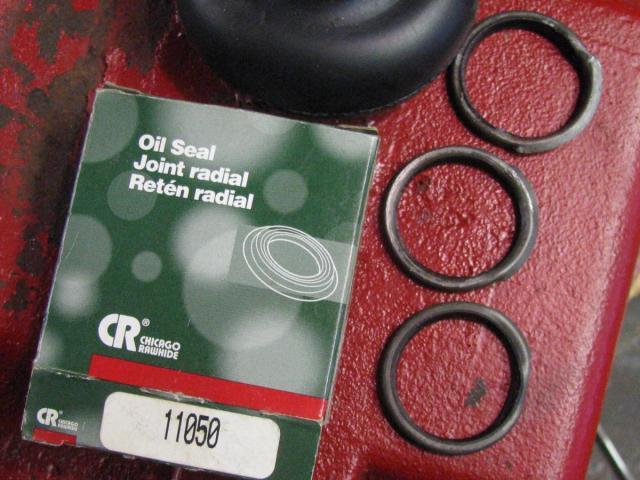

Yep, mine is the 1-1/8" axle, using the 11050 seal...luckily I picked up three of 'em when I got them...

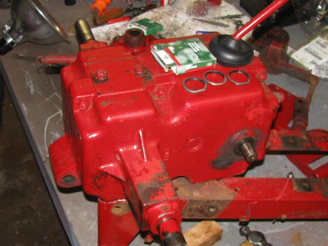

I tried flipping the hub over, and using it to push a new seal into the tube, on top of the first one.
Unfortunately, I met some resistance...3/4 of the diameter of the seal seated fine, the rest got crushed.
Cleaned up the axle first with a file, taped over the keyway, lubed up the seal and axle...and was still denied.
What did I do wrong, gotta be a better way?

Did all that, and then some...
still managed to crush the third, and last one I had on hand last night.
And yet, more are on the way.    :)

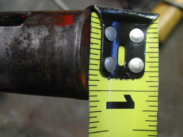

I hate to ask this Craig, but are you sure that axle is 1 1/8".  No way you should have that much trouble with a seal.  :)

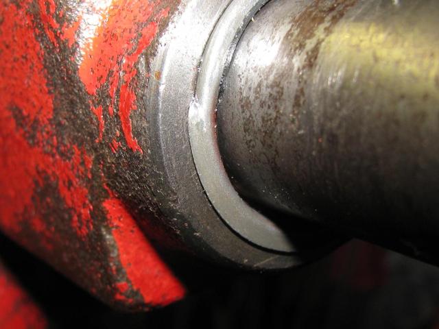

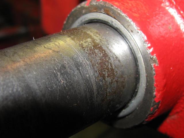

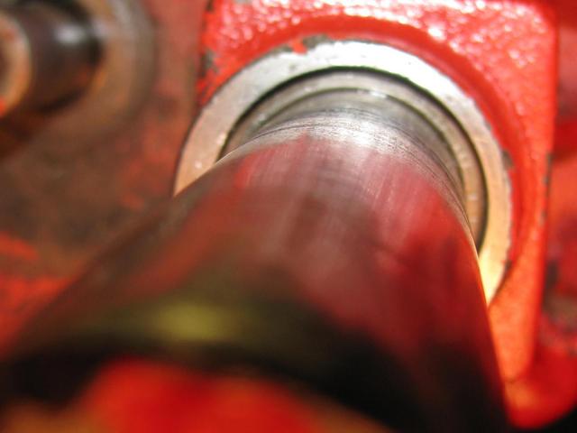

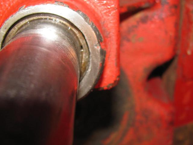

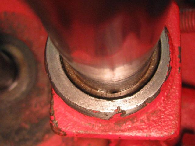

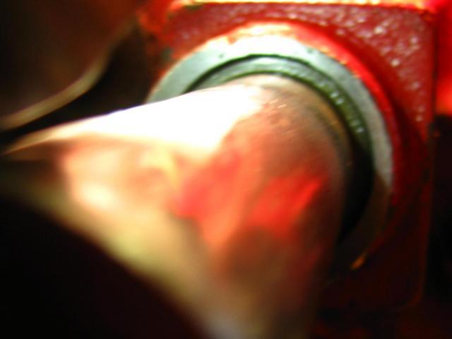

First few picts...you can see the first seal driven deeper into the axle tube...clearly enough room for another to go in there on top of it.
Those picts show the axle bore from the top and bottom of the axle...bottom looks like it was boogered up by someone before me.
Like I said...I taped over the keyway...lubed up the seal and axle, chamfered the edge of the seal with a file, and emory paper...
each time the seal looked like it was seated all the way around, 3/4 of the circumference seats fine...last tap keeps blowing out the side as shown in the last picts.

Craig, in your next to last pic in your last post the rubber on the seal looks like it is rolled to the inside. It could be that the rubber is jammed into the first seal causing it to be distorted and creating a leak point. With the few seals I've installed over the years the rubber was always rolled to the outside and rode smoothly on the axle surface. I would try one more seal making sure that the rubber does not get rolled toward the first seal and see if that corrects the problem. If it doesn't then it's time to open up the trans, get the diff out, remove the inner seal and put in new bearing to the proper depth then use a new seal. That should take care of the problem.

I think the iron edge of the trans case that the o.d. of the seal slides into is messed up enough to catch that seal edge and distort it going in all the way. For all we know the edge may be tapered  and wedging the seal. Don't forget, The axle was leaking and there were 2 seals in there. It's had a hard life. One thing I learned when installing a new part and it's the correct one, and a problem like this keeps happening, The cause is always something stupid that we just don't see. Look at the 2nd pic after the one with the tape measure. That hole doesn't look round anymore to me
Edited by squonk
Her's another thing I thought of  :idea:  :techie-idea: That 2nd seal in there could be fooling you into believing that that axle bearing is good and  tight. I think It should all come apart and be gone thru.
Could a machine shop clean up that axle bore, making it round again?
Maybe the fix is just to replace that side of the trans case?    :scratchead:

Not much chamfer on the on the trans housing, you could file a little more chamfer on it. That might help

if that inner seal is shot, that axle may not be quite centered in the bore
True that Mike...
a closer inspection reveals when driven in the bore, it was deformed also.
