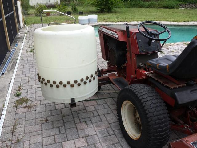

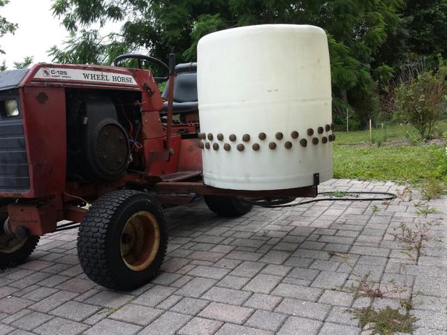

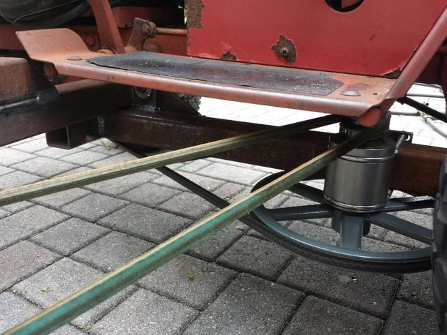

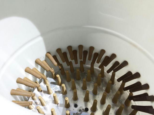

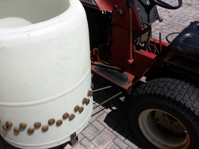

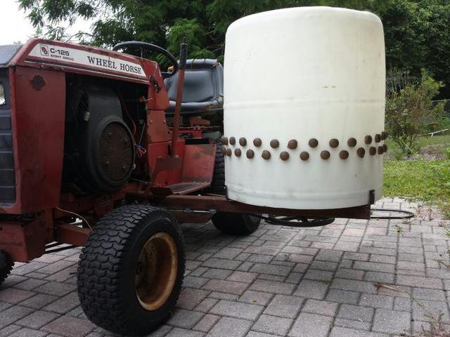

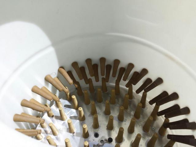

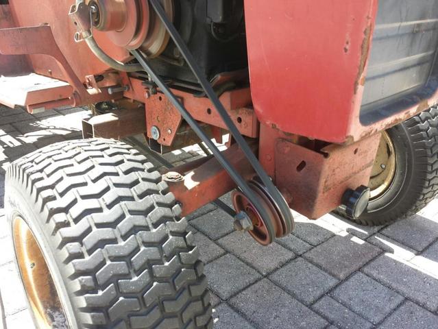

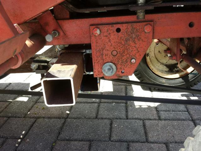

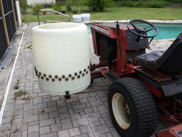

Finally finished the chicken plucker implement.  Okay, it ain't purdy, but it's going to be put to use tomorrow.  Will take video of it in action.  It's a bit on the heavy side, but it attaches in two parts.  The primary frame attaches to the tach-a-matic.  The secondary frame slides from left to right into a receiver on the primary frame.  The secondary belt is installed at this point, the secondary frame is then slid left to take up the slack in the belt.  A hand knob on the bottom is tightened to secure the secondary frame and secondary belt.  The primary belt is the tiller belt, repurposed, threaded from pto to the mule drive to the 10" pulley on the primary frame.  The secondary belt further reduces the rpm 5:1.  I designed the gear reduction to be approximately 12:1.  For the C-125, that should result in variable speed of the feather plate between about 175 to 280 rpm.  I put a photo tach to it and got a reading of about 100 rpm at idle.  At WOT it was about 275 rpm.  Low end was out of line.  Either the engine is idling too slow or I've got some slippage.  I'll have to check it more thoroughly as the numbers were jumping around quite a bit.  I may not have had the best conditions for accurate measurement.
Anyway... here it is!  After I use it tomorrow, maybe I'll knock off some of that rust and give it a paint job.  Or, maybe I'll just start the next project!  :techie-eureka:

You are using actual feather pluckers in the drum!

Well, my day couldnt have gone much worse.  The one bright spot was the chicken plucker.  It worked beautifully!  The two of us only had 11 cornish cross and 4 young  guinea fowl.  The cornish were about 10 lb and the guineas were less than 3.  A couple of the guineas had feet fall between spinning plate and the tub... ie got stuck.  Otherwise, 15 to 30 seconds each.  The biggest problem i had was while dunking a bird in the scald pot.  My girlfriend had placed an aluminum rod we were using to dunk the birds right next to the fire.  It was just far enough away to look like the fire wasnt hitting it... but it was.  Burned my right hand palm bad.  Still have ice on it. Ive only had the use of one hand since.  Of course, all the birds had already been killed.  We had to finish them.  I wasnt much help.  She ended up doing most everything by herself.  Took us 4 hours as a result.  Oh well.  Wuddayagunnadoo?
