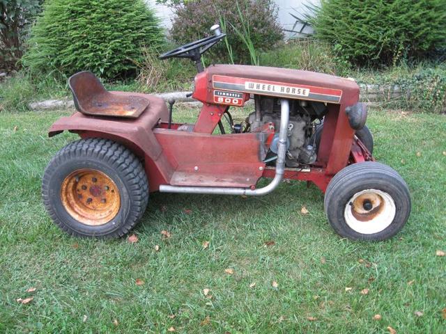

Too good to scrap .... so .... RAT ROD IT!  12.5 Kohler.  7" longer, 7" lower.

as promised,i did indeed post some pics.thinking of running a peerless 700 series trans with 12 horse briggs vertical shaft. electric start,charging system,key ignition.... trans would drive solid go cart style axle with disc brake.i will drop the front down by fabricating new spindles similar in design to older cub cadets.
