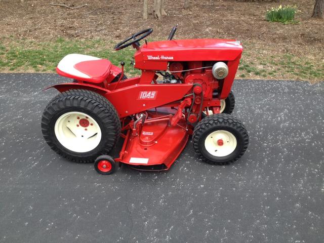

I bought a 1045 last winter that has a seal leaking between the transmission case halves.  I have a new seal and need to split the case to replace it.  I have read some of the threads about splitting the case, and have a couple of questions:
1) When I split the case, which half contains the gears and should be left alone and which half (drive or brake pulley side) can I remove without disturbing any of the gears?
2)  Does the shifter need to be removed for this?
3)  If I take the wheel and hub off the axles, will the case slide off over the axles without removing the axles?
Thanks in advance for your help.

when you split the trans lay it on it's side with the brake hub up.... and it will slide past the axles....nice machine by the way....I know exaclty were that came from....I restored it before Mr Mehlberg got it... :)

And yes...you need to remove the shifter.  Are you sure it is the trans case gasket leaking??  My B-100 is looking like that, but I know it is an axle seal and the oil is just channeling down and dripping right under the trans gasket.  :)

Thanks for the additional info.  If you don't mind, could you please post the pictures you took when you bought the tractor?  I would love to have them for posterity.  I'm also glad that you were able to get the 520 with the hydro lift, Scott is a great guy to deal with.  I am pretty sure where the transmission leak is.  After letting the tractor set for awhile, it is definitely leaking between the transmission case halves, right near where the hitch pin loop is.  I tried putting some RTV in the seam to see if that would stop the leak, but it didn't work.  I also have to open up the transmission on my recently acquired RJ-58 to replace an axle seal and bushing.   When it is all done, I hope to have some decent WH transmission experience.
