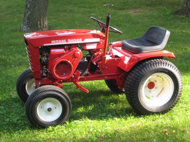

rmaynard 15,719 #23 Posted September 2, 2014 When I ordered paint from my PPG jobber, I specified Wheel Horse red. That is a stock color. The PPG number is 72034. That's all you need. That code can be mixed in their OMNI or Shop-Line series. As stated before, I used a 1.4 tip for both primer and top coat. Here is my Commando painted with single-stage acrylic urethane. 2 Share this post Link to post Share on other sites
Hodge71 664 #24 Posted September 2, 2014 When I ordered paint from my PPG jobber, I specified Wheel Horse red. That is a stock color. The PPG number is 72034. That's all you need. That code can be mixed in their OMNI or Shop-Line series. As stated before, I used a 1.4 tip for both primer and top coat. Here is my Commando painted with single-stage acrylic urethane. IMG_0215.JPG Bob that is gorgeous!!! So Theres no clear coat with that system because its a single stage Bob? Is it durable enough for a worker? All Im worried about is scratch and chip resistance. It looks like what Im after to be honest.. maybe a bit deeper red color but possibly I can achieve that with a dark gray/green or red oxide color primer? I hope to be painting next week after I practice on a spare hood I have here. Guns will be here tomorrow with UPS Share this post Link to post Share on other sites
rmaynard 15,719 #25 Posted September 2, 2014 Theres no clear coat with that system because its a single stage Bob? Is it durable enough for a worker? No clear coat with single-stage. It's pretty tough. Share this post Link to post Share on other sites
