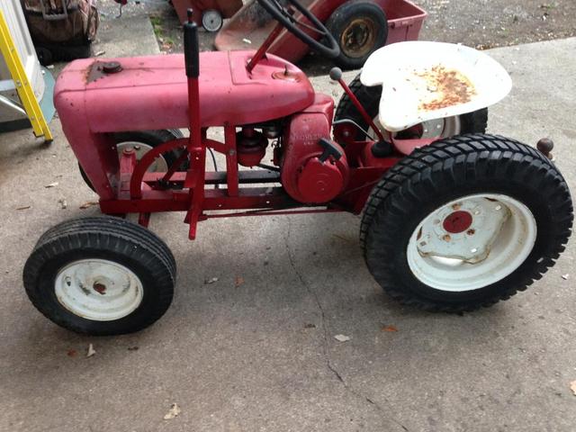

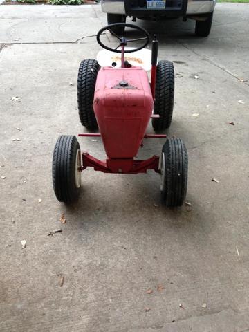

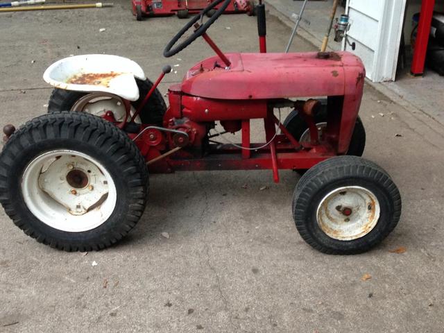

Found this yesterday also
Dhodge
So I added it to my collection. Has a nice little K-90 on it.post-13051-0-28908600-1408791789_thumb.jpost-13051-0-77723100-1408791816_thumb.jpost-13051-0-21377000-1408791848_thumb.j

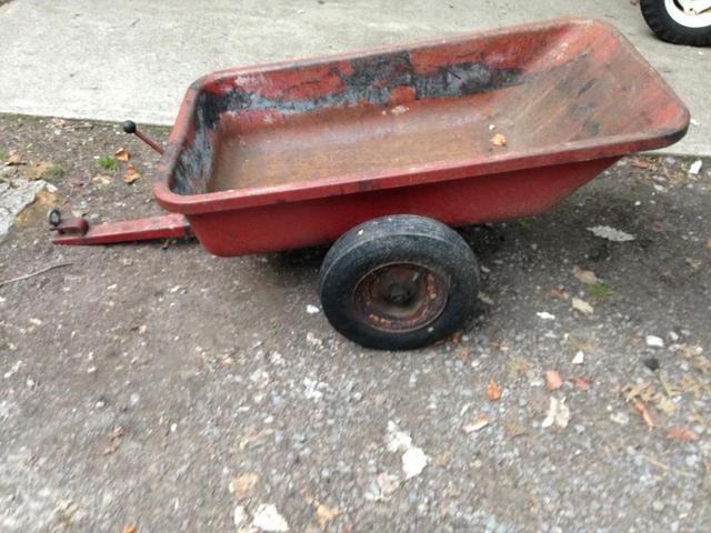

I also picked this little guy uppost-13051-0-35568300-1408791924_thumb.j

You've been busy, very nice additions
Nice four oh one   :handgestures-thumbsup:
Serial/ID tag still on it?

Sweet! That will look great with that trailer in tow.

:woohoo:      Nice tractor/trailer  combo.

Thanks for all the nice comments guys. I drained the oil and cleaned the carb, tank and sediment bowl on the 401 yesterday. It fired up and ran real nice. Had to solder the float in a place or two that had pin holes.
The rear end seems to be a little tight. Have any of you gents had any luck flushing it out with kerosene or fuel oil or should I take the tranny apart, clean and inspect?
Edited by Dhodge
Brought home big lot of 401 parts from the big  :wh: show...
in there was a trans that was all but locked up, could only get it to spin over 1/8 turn.
Flushed, and filled it with diesel for a week, spins like butter now.
Never know...you can give it a try first.   :handgestures-thumbsup:

Good advice. If it doesn't help at least you'll have it cleaned out a bit if you do end up tearing into it.
