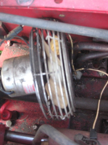

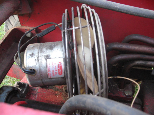

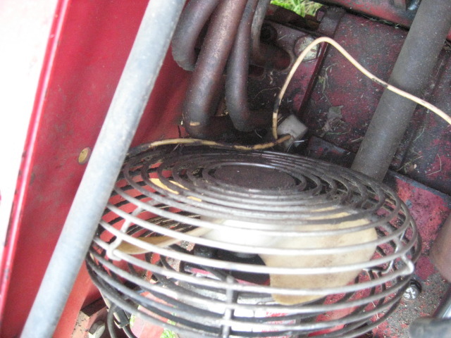

Would like to see a picture of where and how a transmission cooling fan mounts on a "D" - series tractor, looks like it uses two bolts but not sure where. Thanks, Mark.

These are some pics I found once.  I couldn't mount one on mine as it has the easy ride seat.  the seat spring tower uses the bolt holes and block the fans location.

Thanks Paul, I got it now the fan bracket bolts on with the same bolts that bolt the tranny to the top of the frame.
With this, fan position, design it seems rather obvious that one should not attempt to fill the gas tank while the fan is running, as an over-spill or splash of gasoline could go down onto the fan motor, which has a small opening for the wires to exit the housing.
