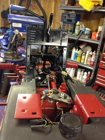

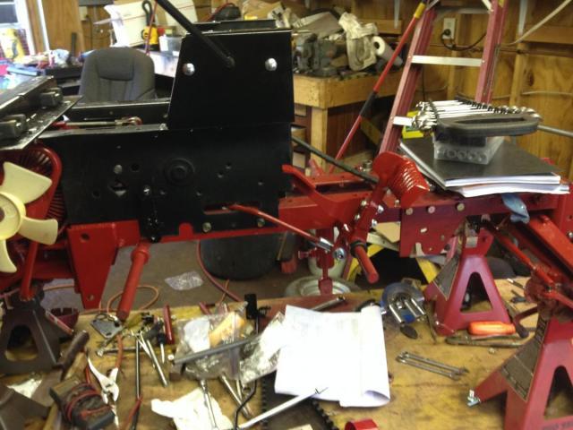

Been scratching my head the last few days trying to figure where parts go and in which direction they go in what holes. I took a lot of photos when I tore it down and they are a valuable asset to me but nothing takes the place of see exactly how each piece fits.
Yesterday I put the Battery floor in that tractor at least 4 times before I got everything put in the right order. So I think I found a great solution.
All you need to do a perfect job of reconstructing a Wheel Horse 416-H, is to have another one just like it setting around doing nothing important. I stripped the sheet metal off and gave it a good power washing, which it needed anyway and now I won't be wondering around with my finger you know where looking for a place to put a part.

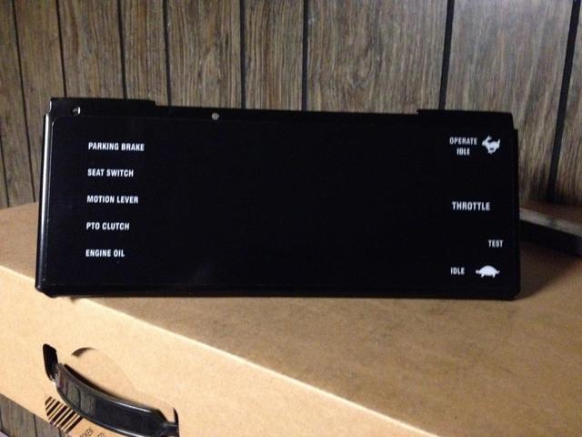

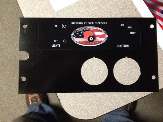

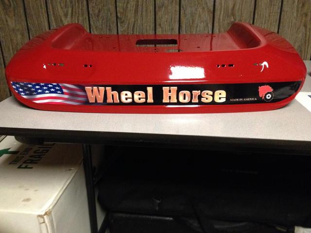

Since I need to wait for the foot pedal from Matt, I decided to put a few decals on the old girl.
post-2564-0-25335900-1411264319_thumb.jppost-2564-0-64123600-1411264343_thumb.jppost-2564-0-19917300-1411264357_thumb.jp
I am going to get an Exacto knife tomorrow to make good clean cuts for the holes. I can't do the hood yet as I need to wait for the paint to dry and then paint the black. But I am liking what I see so far. I really like what Terry did on the decal for the gage plate. Top line says Restored by Nick Caprinolo. Nice touch and much appreciated. He does an outstanding job on these decals. I am glad I picked the Patriotic decals for this one.

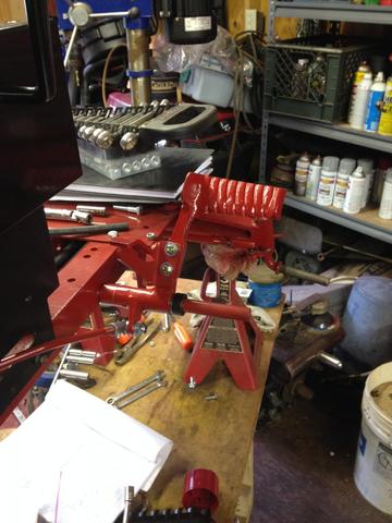

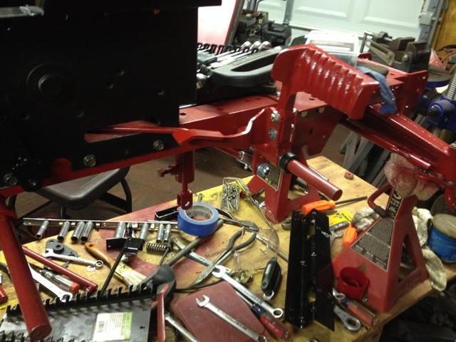

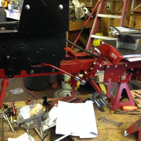

Got a chance to go outside today and what a beautiful day it was. I installed the Foot Pedal I got from Matt and after a bit of fitting got everything adjusted the way I  think it should work. Of course I won't know until I get it on the floor with an engine in it. Actually was a very easy installation. If it works the way I expect it will, I will probably order three more. Unless I run into something complicated, I hope to have all the innards installed by Thursday. It will soon be ready to sit on the floor.

Yep. A lot easier than I thought. Toughest part is the final adjustment. Once I figured which way to turn things it was a piece of cake. I did have to cut about 1/4 inch of one off the rod running from the pedal to the cam bracket.

I am glad you chimed in here as I keyed on the link and got another look at your installation.  After looking at your application I see that I need to go back and make a small modification to what I did. I can't believe I was that stupid I left out the auto center lever and the parts that go with it. When making the installation I did not actually read all documentation. If I had I would have realized by what it was called it was needed. As it was, I had everything working the way I thought it should and left it out. It looked like it wasn't needed.

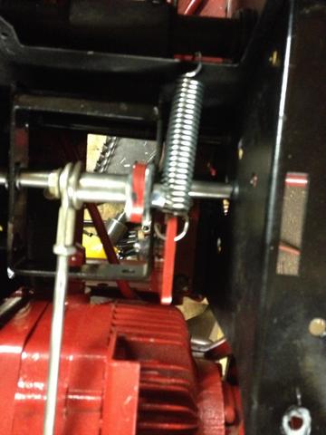

I have the foot pedal completely and correctly installed this time. Really it is not brain surgery. I don't know what the heck I was thinking but as soon as I took a second look at it everything fell into place. The only problem I had was getting it to rest in the neutral position and keep the reverse lever from hitting the floor board. I finally had to cut about 3/4 of an inch off the rod running from the pedal to the Hydro Cam. Luckily there were plenty of threads at the foot pedal to make the proper adjustment. One more thing I have to do is drill a hole for the spring to attach to. It appears that this will be a very smooth way to operate the tractor.

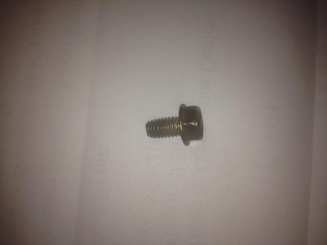

I searched everywhere for these bolts. they are tapered and don't need lock washers. Anyone have a source for them. What are they called?

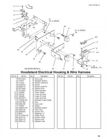

Need part number 11, Fuse holder bracket and number 18, Guard bracket.
I am going to have to tear the whole shop apart to find them and they are holding me up. I don't want to go any further because if I install the motor then I won't easy have access to install them.

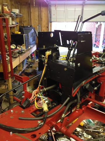

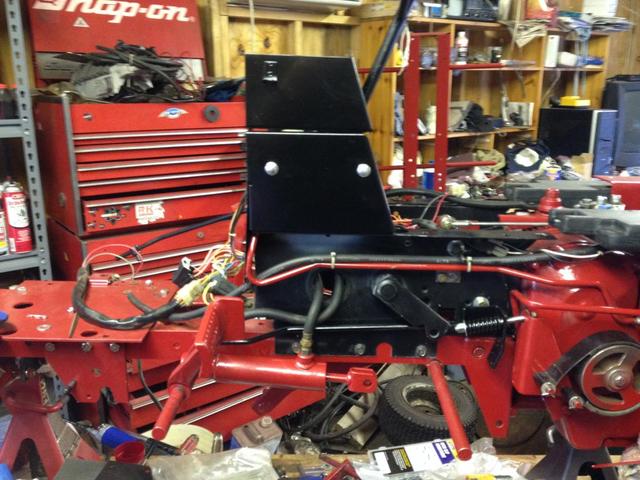

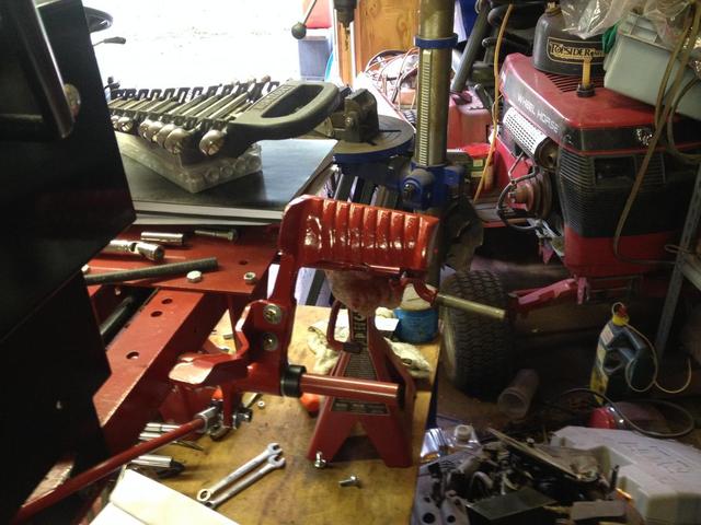

Steering is in and the wiring is laid out and partially installed. Not much more to do. I will be putting the wheels on soon so I can put it on the floor for finishing.
I did some tweaking on the foot pedal from Matt and now it centers perfectly when you take pressure of it. This has got to be a big improvement and a more comfortable way to operate this tractor. Now I am going to have to order three more of them.

Nick, the taper is just to cut the initial thread at assembly, they don't need to be tapered and if you look closely it's just the first few threads. The rest is parallel, McMaster Carr carry shouldered bolts that the head is similar to these.
I like to hoard used ones and replate them, like was mentioned above they are also available new but $$$$......
