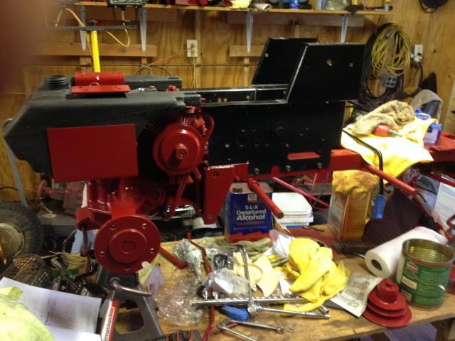

Believe it or not, I did actually get some tools put away. Then I got sidetracked. My garage is an attraction for the neighbors and they stop by often. We had a few beers and after they left I decided to do a little more on the tractor.
Got the shift plate on and the fuel tank. Don't want to get too far ahead as I know I will have to drill a hole in something after I get the foot pedal from Matt. I also got the brake band on and bolted down the dash pedestal.
After I get the foot control all bolted up, I will put the wheels on and get it down on the floor to finish it up. I need to get new tires for it but that will have to wait till next month.

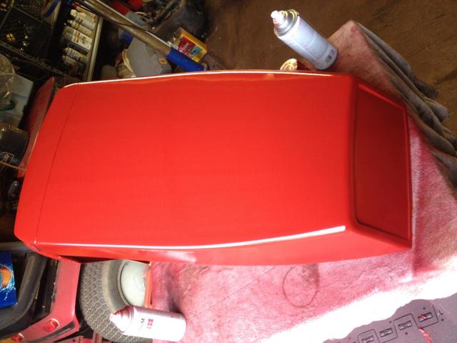

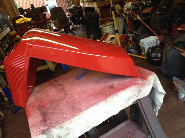

Came home and fooled around out there for a while and decided to repaint the hood. Sanded it down smooth and painted it. This time it turned out the way I wanted it to. No bugs or dust.
I also finished installing all the hydraulic lines.
post-2564-0-34009600-1411087597_thumb.jp post-2564-0-21172700-1411087639_thumb.jp
While sanding it down, I believe I discovered what wet sanding will do, if it is done right. While I did not wet sand it, I did use some very fine paper. I could see the orange peal just disappear as I sanded. When I get this job finished I am going to experiment with an old MTD hood I have laying around here. I believe it would be worth the time to teach myself to do this and then polish it up real good.

Geno
You're gonna really like wet sanding.  When it's wet you can see exactly what you'll end up with better.
km3h
Yes, I think I will but not on this project. I am scared to touch this hood again and it will do just fine the way it is. I will wait two days and then move it inside to the basement. Going to leave it sit there for a few weeks before I touch it again. This Rusty O paint does not dry very fast. When I was sanding I could tell that it was not really hard yet. Next one gets sprayed with a gun and hardener.
