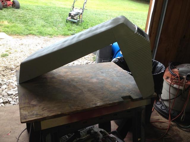

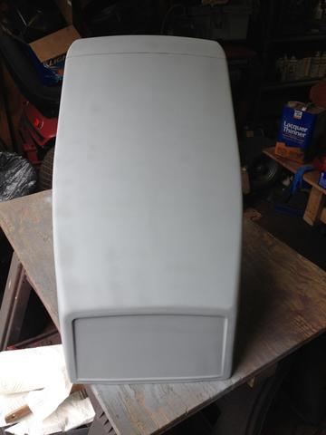

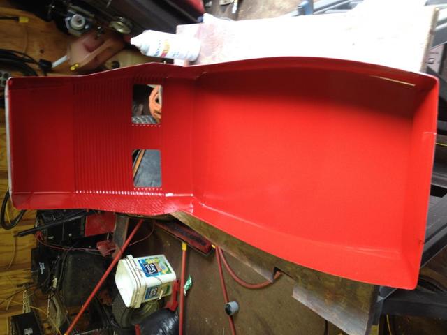

Put two coats of primer on the Horse today. Tomorrow I am going to sand that critter till she is as slick as a baby's bun.
post-2564-0-15588200-1410208955_thumb.jppost-2564-0-56364000-1410208969_thumb.jp
Hope to start final assembly later this week. This is the last piece that needs painting except for the wheels and I will wait to do that until after I get a new set of shoes for the old girl.

This isn't gonna take you long at all is it.   :text-+1:

I hope not. I took a couple days off this past week because it was just too hot for me or I would already have everything painted. I work that way sometime. I get motivated and just jump right in. I would probably be halfway finished the assembly if I could have used the hood from my 417 but it has louvers and that just won't do. Then I lost three days with the crap in my eyes. After I made the last post I went back out and sanded the primer and am ready get to it in the morning. I will probably put two coats of paint on her. I will let it dry a few days between coats and sand.

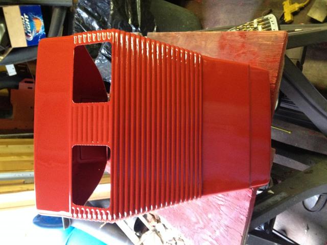

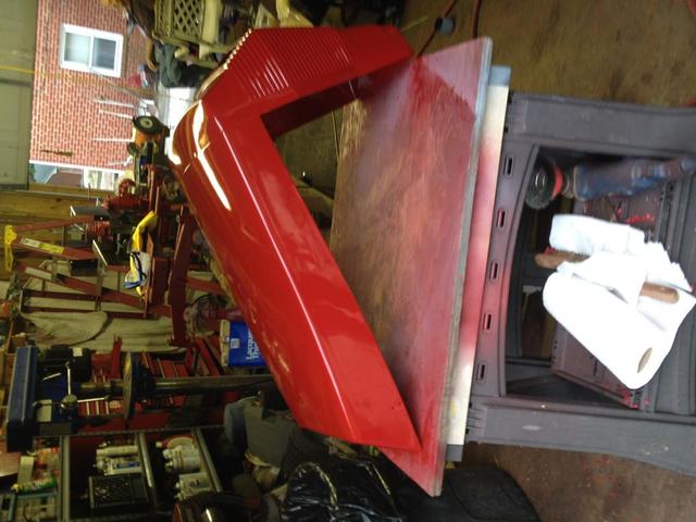

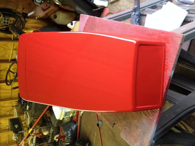

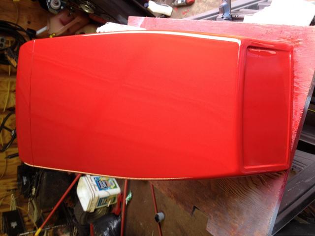

Moving right along, I painted the hood today. Last big painting project for this tractor.
post-2564-0-54387300-1410306040_thumb.jp post-2564-0-94839200-1410306054_thumb.jp
post-2564-0-15807700-1410306077_thumb.jp post-2564-0-07857800-1410306093_thumb.jp
post-2564-0-59416300-1410306106_thumb.jp
I will wait a few weeks to mask and paint the black. I don't want to take a chance of marring the paint with masking tape. I am really getting torqued over this project. Can't wait to finish and start the 417-H. I also want to take the motor off the 520-H and open it up to check it. Life is good here on the shores of the Chesapeake Bay.

Very nice paint work.  What did you paint it with?  :)
km3h
Good old Rust-O Regal Red. I have painted with a spray gun and I don't think IO could have gotten a better finish than this one even with a gun. I would defy anyone to tell me the difference.
Last night I used 600 grit on the primer and got it very, very smooth. Today I grabbed the rattle can and gave it a good shake and went at it. Spray it thin and keep the can moving and then go back over it again. Grab a cold beer and lite a cigarette. Finish the Cigarette and then recoat.
Then you grab another cold one and sit in the garage door and watch the grass grow. Every five minutes you get up and go back to the work area and smile.
Tomorrow if it does not need a second full coat, I will move it inside the house for a week and let it cure. Then maybe I will mask it and paint the black. Or I might wait another week. I still have a lot of parts to install so there is no real hurry. I talked to Terry last night and am waiting for the dash decals anyway. He shipped them out today so they should be here in a few days.

  On 9/10/2014 at 12:54 AM, km3h said:
Good old Rust-O Regal Red. I have painted with a spray gun and I don't think I could have gotten a better finish than this one even with a gun. I would defy anyone to tell me the difference.
I agree, that's why I had to ask.  :)

You layed all that beautiful paint and have not installed the headlight bracket yet? Whats your plan stan? You mentioned tacking it back in place a little earlier. Looks great! I would hate to have to see you touch it up because of the install

I will use pop rivets. I know it won't be original but when I took the plate out it was riddled with pin holes from rust. I knew if I put it back I would not be able to get it coated with a protective coat of paint so that's what I decided to do. This is not going to be an exact reproduction as I am going to use the patriotic decals.
I will wait for the paint to get hard and put masking tape over the paint and drill the holes, remove the tape and pop the rivets in.I do not believe it will detract from the appearance at all.

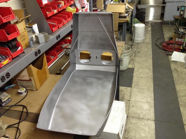

I guess your hood didn't have the reinforcing bars.
Martin
Nick, i think Don is talking about these......
post-4321-0-85563600-1410475814_thumb.jp

I've seen them both ways, my 414-8, 312-8 and 520H has them but my 417A doesn't.  Something new to learn, which ones have them and which ones don't.   :eusa-doh:
Martin
they were a design change to stiffen up the hood. not sure when it was done, all my 90s tractors have them.
Geno
You may be on to something there Martin, my 417 is an 86, and the other 3 are 87 414, 89 520, and 90 312.  :eusa-think:
If this is true it would help us narrow down a year range by simply looking for the bar, if the hoods were original that is.  :)

This tractor does not have the braces, but I have another one out there that does. I will have to go out and check the numbers to see what year it is.
