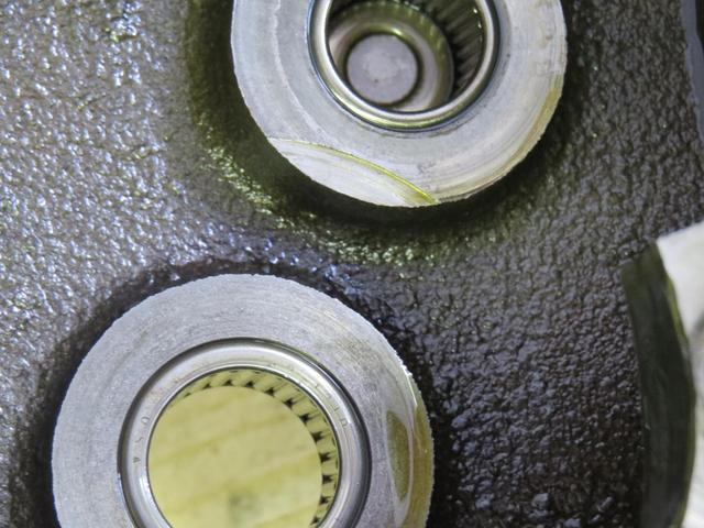

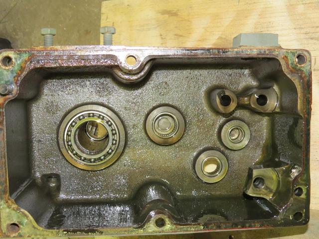

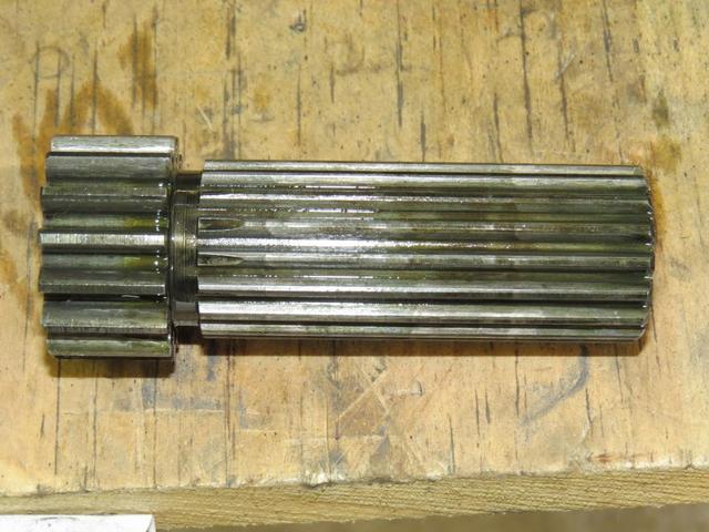

rustykan 140 #3 Posted August 10, 2014 Wasn't planning on taking the transmission apart, but now that it is, is there anything I should look for? I am going to replace all of the seals and one of the axle needle bearings fell apart. I am assuming they aren't supposed to do that. All in all, it looks like it is in very good shape for almost 40 years old. In the first photo, is the case supposed to look like that or is it a wear mark? The second and third photos appear to show some of the splines worn. If that is the case, should I be concerned? Share this post Link to post Share on other sites

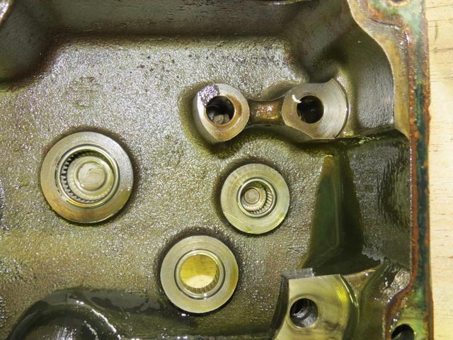

stevasaurus 22,995 #5 Posted August 10, 2014 In the 1st picture, that is a wear mark. I am assuming that the bottom threw bearing is where your input shaft goes. There should have been a "thrust" washer there on the input shaft that might have held the gear up enough to not make that mark where the cap bearing is. The case is OK, and I would not do anything to it, but I would take a good look at the gear that did that. I think I would replace that spine gear though, if you use this horse as a worker. Send a PM to "racinfool40" Mike...he sells those (used) and will send you one. He will have the thrust washer also if you did not have one. I also think I would replace both axle bearings, as one of them fell apart...they are not expensive. $10 to 12 apiece. Maybe post another picture of that case half from a little farther back with the camera. I would like to verify that one bearing is the input shaft. Share this post Link to post Share on other sites
rustykan 140 #6 Posted August 10, 2014 In the 1st picture, that is a wear mark. I am assuming that the bottom threw bearing is where your input shaft goes. There should have been a "thrust" washer there on the input shaft that might have held the gear up enough to not make that mark where the cap bearing is. The case is OK, and I would not do anything to it, but I would take a good look at the gear that did that. I think I would replace that spine gear though, if you use this horse as a worker. Send a PM to "racinfool40" Mike...he sells those (used) and will send you one. He will have the thrust washer also if you did not have one. I also think I would replace both axle bearings, as one of them fell apart...they are not expensive. $10 to 12 apiece. Maybe post another picture of that case half from a little farther back with the camera. I would like to verify that one bearing is the input shaft. Here is another photo of the case, a little further back. Where can the axle bearing be found? I have had no luck with the Toro part number 1526. All say discontinued. Share this post Link to post Share on other sites
stevasaurus 22,995 #7 Posted August 10, 2014 A little farther back would be great. I think I am looking at the deeper half of case of your trans. This would make that threw bearing where your break shaft come out. That mark may just have been a milling mark from the factory and is not an issue. If you have 1 1/8" axles...you want the KOYO B-1816 and the seal SKF 11050. These are available from Motion Industries or from NAPA. I just bought these from Motion Ind a few weeks ago...the B-1816 was $11.70 for 2 of them and the seals were $5.06 for 2. The TORO 1526 was changed to TORO 9416, but you will pay much more buying them from TORO. What you want to buy from TORO is the gasket you will need between the case halves...TORO #3912...just paid $5.13 for that. It is possible you have 1" axles in an 8 speed trans...you need to check that. Also check the diameter of your brake shaft and input shaft to get the right seals for those. If the input shaft is 5/8" you need seal SKF 6105. If the brake shaft is 3/4" you need seal SKF 7410. If your brake shaft is 1" you need seal SKF 9815. 1 Share this post Link to post Share on other sites

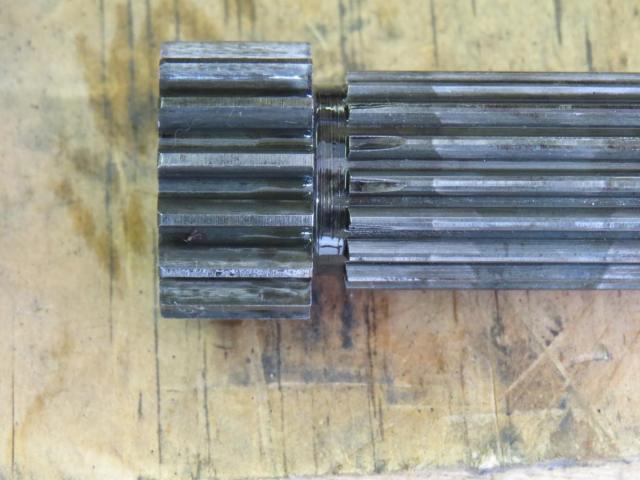

stevasaurus 22,995 #8 Posted August 10, 2014 BTW...where those chips are out of that spline gear...that is where the 1st/reverse fork gear would be positioned when your horse is in 1st gear. Share this post Link to post Share on other sites

Desko 610 #11 Posted August 12, 2014 I believe those smaller splines should have those cuts because if you look at them al the way around they tapper to smaller and smaller I have rebuilt a 4 pinion and an 8 pinion and both have the same markings on them. If its on the larger gear at the end of the splines should not have any chips missing. 1 Share this post Link to post Share on other sites
stevasaurus 22,995 #12 Posted August 12, 2014 You want the bearing without the lube hole. They do show the seals...type in these catalog numbers in the search box on their web site... #01295997 for the SKF 9815 1" seal #01295057 for the SKF 7410 3/4" seal #01321238 for the SKF 6105 5/8" seal #01296483 for the SKF 11050 1 1/8" seal #00090569 for the KOYO B-1816 1 1/8" bearing #01295997 for the KOYO B-1616 1" bearing if you have 1" axles I have found that the prices they show are not always what they charge you...most of the time it is a little cheaper. I pick up the parts at the outlet...so no shipping. That case half looks OK. Be careful cleaning the rust off the edge of the case. I would just use a wire wheel to clean it. Share this post Link to post Share on other sites
