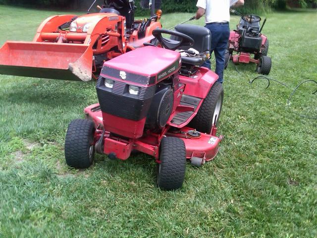

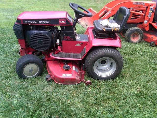

Well I hope my will look a lot better when it is finished. Of course Denny did not have what I have to work with. He did a great job on that tractor. What a difference.
This is what I will be working on. Just got it today.
post-2564-0-83677900-1406055615_thumb.jp
post-2564-0-38158400-1406055638_thumb.jp
post-2564-0-07164200-1406055663_thumb.jp

Meguiar's body scrub makes old oxidized paint look new. Especially the color red.
Zeek
If the paint is oxidized or severely faded:
  1. Compound
  2. Swirl Remover
  3. Wax
Personally I'd give this a whirl https://www.youtube.com/watch?v=giCdGU2xZic   Little less work . . .
I've used these products with good success.
shallowwatersailor
I've had good luck with Meguiars Compound and Polish with my HF Polisher/Sander. But for some reason, my 1990 520-H was faded and I still could not bring it back. It was shiny  when I finished but still faded. That was when Toro started labeling the tractors as theirs. Maybe they had a change in paint formula?
