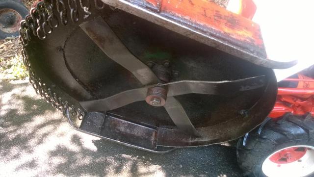

shallowwatersailor 3,214 #8 Posted July 3, 2014 Gravely had the option (and still has parts available) for the old brush hog mower to run two 30" blades. One of my brush hogs is setup that way. I'll take a picture tomorrow in the daylight. Share this post Link to post Share on other sites

shallowwatersailor 3,214 #11 Posted July 3, 2014 Here is the Gravely setup on the 30" brush hog on my C-8. It is a fitting that holds the blades in place. Share this post Link to post Share on other sites
