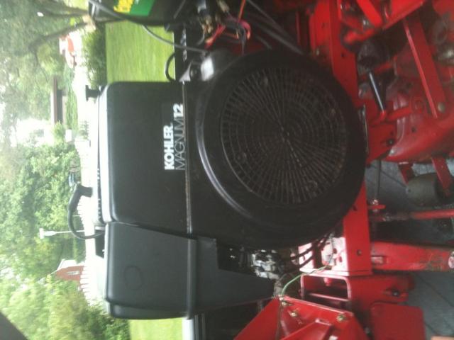

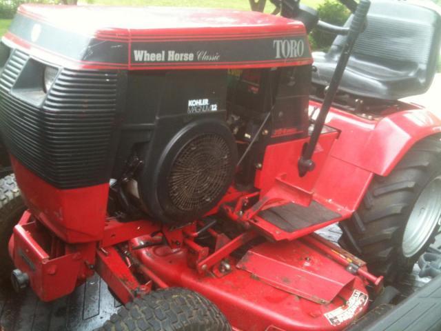

Bought a couple of horses several days ago and picked them up today and brought them home.
Neither one runs right now and I'm not sure what is wrong with each one, but I got them reasonable and if I have to part one or the other out, I will get my money back and then some!
Here are the requested pictures!
1981 C-125 (with a 14 HP Kohler Magnum transplant)
1976 C-160
Edited by KC9KAS

The C-125 looks like it's got a transplanted Kohler Magnum 14 hp engine in it - very good!
Nice score!
