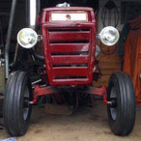

Stigian 1,234 #237 Posted May 28, 2015 Oeh i see WH tire smoke in the near future You do indeed Koen, test drive time is not that far off now Yesterday the engine frame got the treatment.. Some final welding and a bit of smoothing out.. Here the frame is fitted to the engine so I could make a mount for the coil pack..It always amazes me how a quick coat of paint can change how something looks... A red metal sculptureEngine and a few other bits bolted back on.. The wheels were only thrown on to see how the front end looked.. They will be coming back off to fit the new tires/tyres.A close up of the front end... Me likes how it looks Before the rear axle could go back on I had to pull it apart again! The mounting holes needed to be made slightly bigger but the brake backing plates were in the way stopping me getting the drill in... So it was easier just to pull the axles out to get the backing plates out the way.I also needed to drill a small breather hole in the top of the axle and fit a jiggle pin.. A jiggle pin is a small split pin that's a loose fit in the hole.. The idea is the pin jiggles about and stops the breather hole from getting blocked up.. 5 Share this post Link to post Share on other sites

Stigian 1,234 #246 Posted June 9, 2015 getting very excited now!where are you going to test out it 100mph abilities? old airfield maybe?hope the finishing off goes smoothly, not too many creases to iron out Thanks Callum. We have a couple more possible options for high speed testing that are worth looking into. But no rush for the high speed stuff, best take my time and get WN operating good to start with.Evening guys, today's "to do" list looked something like this.... Find out why the fuel tap is leaking.. Fill diff with oil. Finish the wiring, it's about 90% done. Finish the prop shaft.. About 50% done. Bleed the brakes again to get the last of the air out. Warm the engine up and change the oil. Set the front end up. Get WN off the bench.. Go for a test drive Well, I didn't quite make the test drive deadline today, but getting very close.. Due to a measuring problem I had to make another sleeve to join the 2 parts of the prop shaft together... For once I can say the measuring cock up wasn't down to me but measuring calipers.. Nigel will vouch for that as well! Getting the engine running again was fun.. The spark at the plugs which was there yesterday had vanished today!! After lot's of searching and ing I traced the problem down to the run/stop switch which had decided that the run position just wasn't an option any more! So sorting those two problems kinda killed any chance of a test drive today But there's always tomorrow The amended "To do" list.. Find out why the fuel tap is leaking.. Fill diff with oil. Finish the wiring, it's about 90% done. Finish the prop shaft.. About 50% 90% done. It just needs welding and fitting. Bleed the brakes again to get the last of the air out. Warm the engine up and change the oil. Set the front end up. Get WN off the bench.. Go for a test drive With WN off the bench it only seemed fair that I rolled her outside for a few photos.. For me... This one really hits the spot 6 Share this post Link to post Share on other sites
