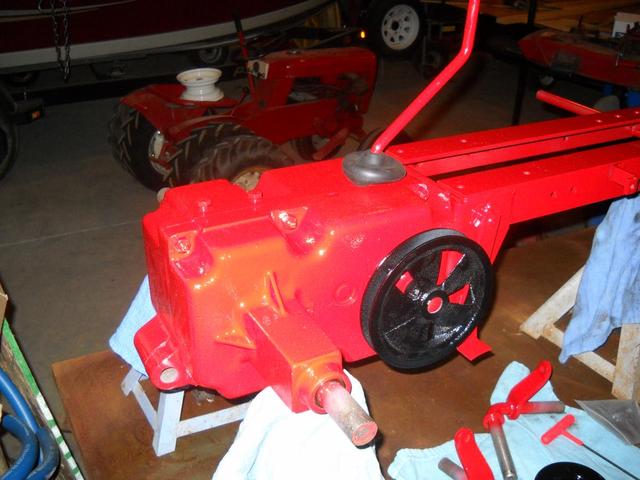

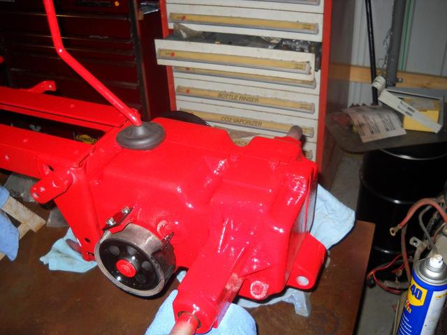

W/H JUNKY 43 #1 Posted June 14, 2014 (edited) When i refill the trans do I fill it up until the oil comes out the hole on the side. Or should I add more? There is no dip stick on this trans. It just seems like the oil level should be in the center of the axle bearings. Edited June 14, 2014 by W/H JUNKY Share this post Link to post Share on other sites
