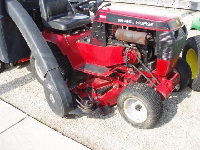

What's the best way to determine what series Trans is in the Tractor?
post-13072-0-60019200-1401672182_thumb.j

if your talking that tractor, it has a eaton in it, if it has hyd lift it's a eaton 1100, if manual lift it's a eaton 700
leeave96
+1
That is a late model 314-H and I am 99% positive you have an Eaton 1100. In addition, the transaxle is an 8 pinion and 1-1/8 inch axles. Very strong and reliable transmission - one of the best.
Overall that Wheelhorse IMHO is one of the best ever made.
If you add Matt's foot control kit, it will be as modern as any tractor being offered by Deere or Cub.
Wade
Sounds like I better stop thinking about it and see if I can make a deal. It has a blower ,single stage with the long shoot. 660hr. It looks like it has been taken care of. What would you consider a fare price. It has the power lift so your ,right it is the 1100.

I have a twin to that. Wonderful machine! Easily $1000-2000 with that equipment. Maybe more if everything looks as good as the photo. Did you buy it?

Yes I did buy it. I ended up paying $800.00 for it. It runs out pretty nice the lights on the dash for the safety items all work,the blower is in ready to use shape. The mower could use a new belt and the Vac system has a bent flight on the fan, the cooling fan had broken blades ,and the tie rods are a little loose but all and all I think I did ok.

Make sure the first thing you do is replace that fan blade. That transmission is the best but none are any good when they overheat! Nice tractor. Nice price!
