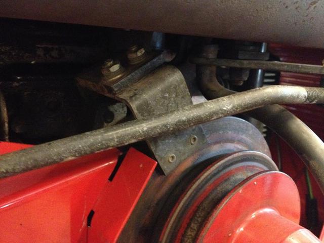

as far as the clutch goes, mine spins a little when no belt on it, the brake needs adjusting if this is the case, i don't worry about it too much, but there is a bracket that bolts to the pto upper bracket that has friction material on the back side of it. when the clutch is disengaged the bell of the pto rests against it and if adjusted properly it will keep the bell from rotating with the engine......

I do not know if there are different specs. for each engine, but the K series Kohlers require that you engage the clutch, then place a .012" feeler gage between the clutch brake and pulley face, then adjust and tighten the brake.
