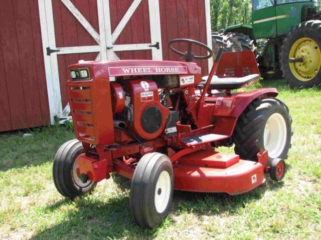

74 C-160 refresh and mod

Nice looking machine. Like your choice of tires.
Jake Kuhn
Nice horse!
redrooster
It looks great. Nice job! [emoji122]
chazm
Nice :wh:.... :eusa-clap:
AMC RULES
:woohoo: Big block Techy power!
Turned out very nice indeed.   :handgestures-thumbsup:
can whlvr
very nice lookin tractor,you did a great job even if it has a tecky :ychain:

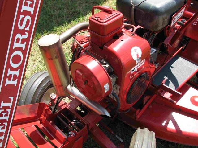

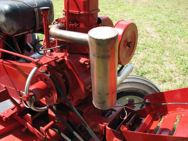

When I got this tractor, it only had a round, can style muffler on a 1 in. pipe straight out the side. I never did like the thing and always hated how loud it was. Mowing after dark, I could see fire coming out the side. I wanted a more original muffler that would be a little more effective. I had thought about a stack, but decided I wanted to keep everything under the hood for clearance under trees and a cleaner look. An original Nelson muffler was non-existent and pricey, so I decided to make one out of stainless. Here's what I came up with.post-11894-0-64934100-1400465470_thumb.j
post-11894-0-54279400-1400465580_thumb.j
The main shell of the muffler is a piece of stainless from a submersible well pump housing. The in and out pipes, as well as a small piece inside, came from a 1 1/2 in. shower grab bar. That stuff is an art to weld, but I was very happy with the way it turned out. Nice and quiet with a pleasing burble under load. No, I'm not going into production. It took way to long to make for anybody else to afford one. :)  What else do you guys see different?

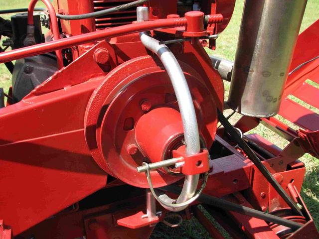

Here's a few pics of one of the other upgrades that I've done to this tractor. I've read here on Redsquare of other people who thought that their blade speed was too low to develop good suction and make a clean cut. The standard answer was that "It is what it is"-if you want a high vac deck, buy a newer mower or use the 37 in twin blade deck that cuts better. I know that most commercial mowers run their blade tip speed between 18000 and 19000 feet per minute. After a little calculating, I realized that my blades were nowhere close to that. The larger/inner groove in my PTO bell was worn quite a bit and I had trouble keeping the belt tight enough that it wouldn't slip, so I decided that I didn't have much to lose. :techie-eureka:  I chucked it up in my trusty lathe and cut everything down to a 2.5 in. diameter. I found a old pulley in the "spare parts bin" that I think came off of a JD spindle. Into the lathe it went and out it came with a 2.5 in Inside diameter. Drill and tap 4 holes for 1/4 in. bolts and I have a 5.5 in PTO pulley. :)  Calculated blade tip speed is close to 17,500 fpm. It seems to cut better and I hope the increased speed will allow me to cut in 3hi and still leave a clean cut. There's no reason an old horse can't cut as good as the modern Z-turns. :handgestures-thumbupright: The Tecky still seems to have plenty of power. I haven't tried it much and if it seems to be too much, I can always find a smaller pulley to put back on. Adaptability-that's the WheelHorse way!post-11894-0-06777500-1400625669_thumb.j
  • Like 4

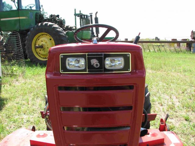

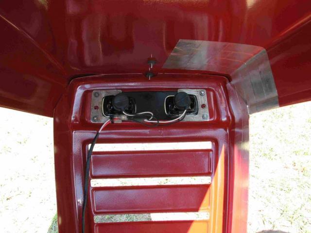

One more mod to give a few picts of. Lots of people complain about the poor headlights in the c-series. A 1156 bulb just isn't very bright and the reflector assembly isn't that great either. Replacement bulbs that give more light also often give more heat and melt the plastic lens. My brother kept giving me grief about my lights compared to his old Sears tractor that has honest sealed beam lights. He pointed out some small rectangular halogen driving lights and told me I needed them in my horse. I took a piece of aluminum plate and shaped it to match the original headlight lens, then cut out holes to place the lights approximately where the original lights would be. I had to make a few clamps to hold the lights into the back of the plate, and used the mounting screws to hold it all together. I asked Terry to come up with a decal for the front plate and he sent me a black and chrome decal that is just perfect. Here's some picts. What do y'all think?post-11894-0-92288600-1400722764_thumb.j

I like all the mods. you made them all look part of the tractor and not out of place.
the lights really finish off the front.....
tbarnhart
Thanks for the compliment, Martin. I tried to improve the weak spots in the design and yet retain the charactar of the original tractor. Everything I did is reversible as well-original parts will bolt right back on. I forgot to mention, the lights are 55w H3 halogens and really light up the night. Its now possible to mow after dark.

One more mod to give a few picts of. Lots of people complain about the poor headlights in the c-series. A 1156 bulb just isn't very bright and the reflector assembly isn't that great either. Replacement bulbs that give more light also often give more heat and melt the plastic lens. My brother kept giving me grief about my lights compared to his old Sears tractor that has honest sealed beam lights. He pointed out some small rectangular halogen driving lights and told me I needed them in my horse. I took a piece of aluminum plate and shaped it to match the original headlight lens, then cut out holes to place the lights approximately where the original lights would be. I had to make a few clamps to hold the lights into the back of the plate, and used the mounting screws to hold it all together. I asked Terry to come up with a decal for the front plate and he sent me a black and chrome decal that is just perfect. Here's some picts. What do y'all think?attachicon.gifIMG_1402b.JPG
What do you have invested in this modification? I really like it! Any chance you might want to make another?
tbarnhart
The lights were about $20 at Wal-Mart. The expensive part would be the time to carefully cut the aluminum plate to the correct shape and get the holes for the lights in the right places and the correct size. My first attempt, I got the hole for the left light a little to tight around the glass lens and it cracked. I had to get another set of lights and make sure that the light had a little movement all around. So far so good. Terry got me the decal. He custom made them for me but I'm sure he has the pattern and could make some more. I don't really want to make any more but I would be glad to help someone fabricate something for themselves.
