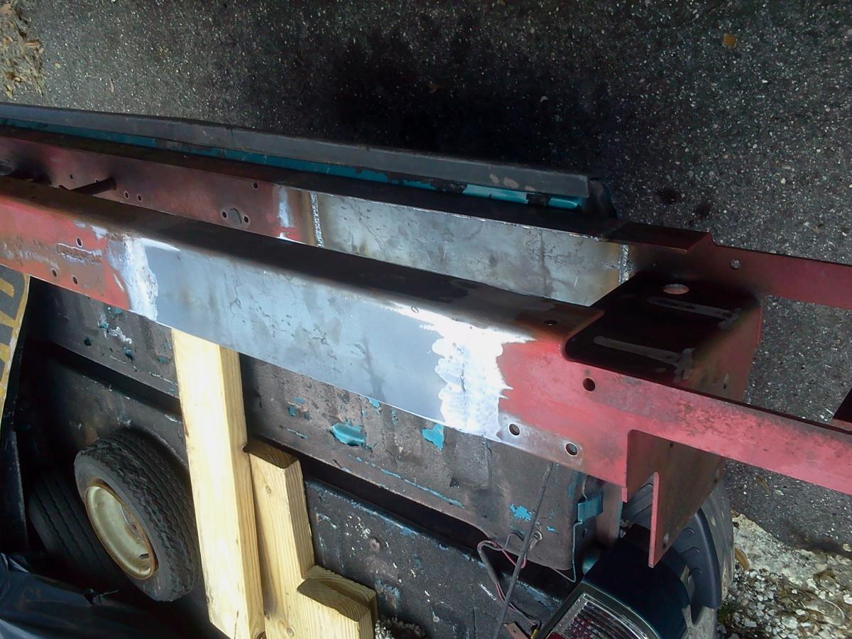

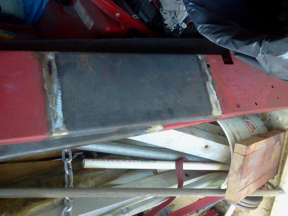

rtfbg 744 #31 Posted June 10, 2014 YIPPEE ... frame pieces are back from the welder!! Hopefully the thundies will let up tomorrow, and I can finish grinding and start slingin' some mud!!! Share this post Link to post Share on other sites

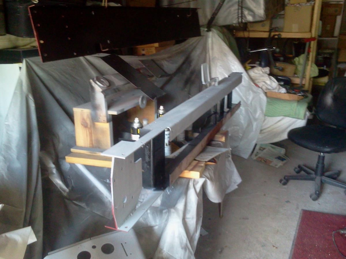

rtfbg 744 #36 Posted June 14, 2014 Well, so far so good with the mud, now ready to sand sand sand!!! Someone asked about seats?? Heck, I have no idea, figured I would sweat that when I got up to that point!! lol Share this post Link to post Share on other sites

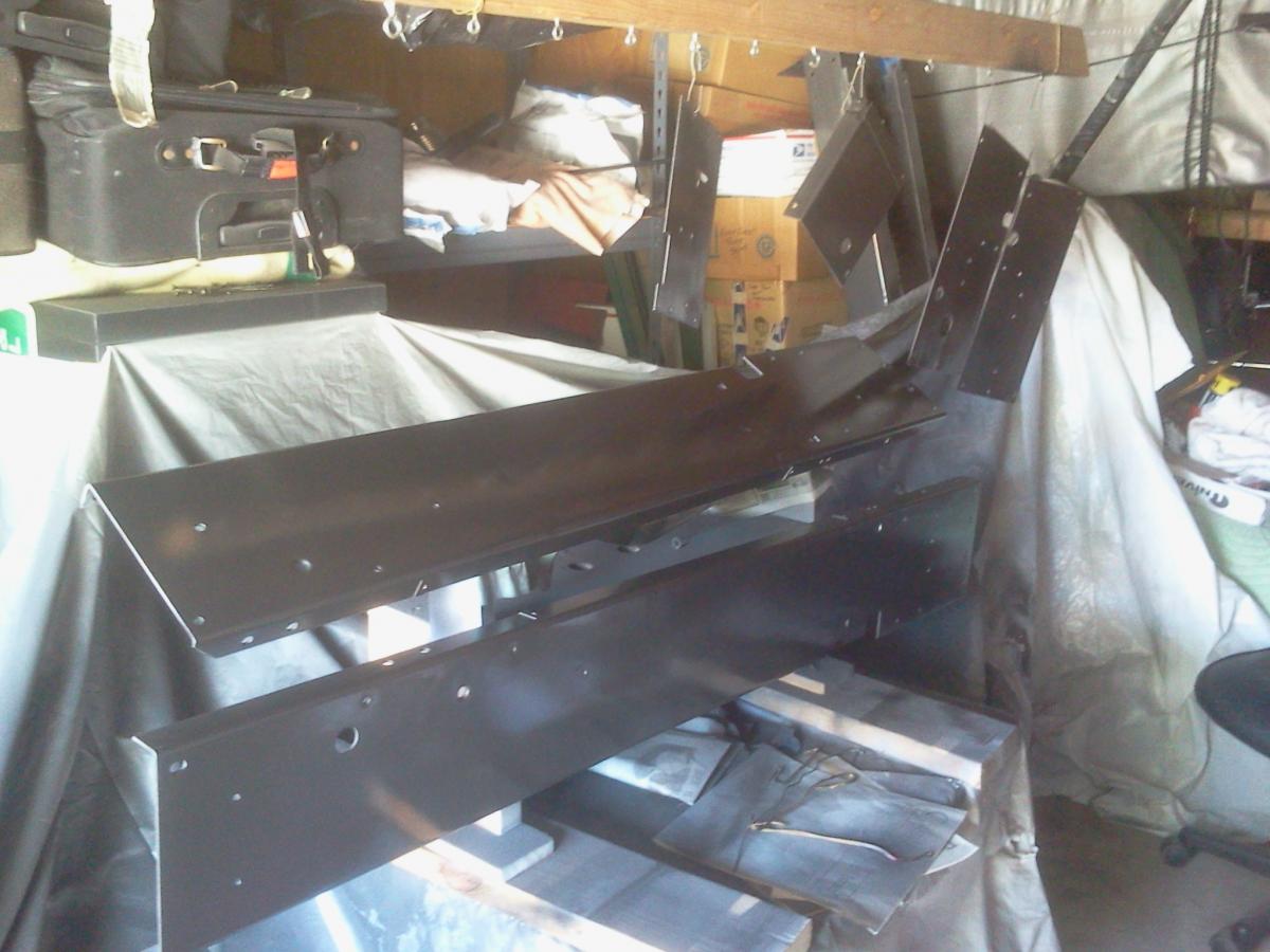

rtfbg 744 #43 Posted June 25, 2014 Makin' slow progress on the chassis parts, the bottom frame section is done, except for the clear. Now waiting 3 days for these pieces to dry so I can clear everything at once. When thats done, I can actually start putting the business end together!! lol 1 Share this post Link to post Share on other sites

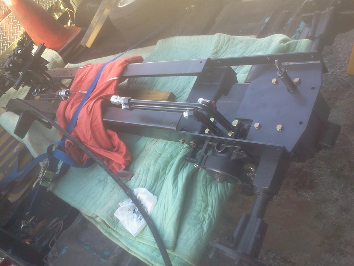

rtfbg 744 #45 Posted July 8, 2014 Well, I got the rear axle mounted, and the pump hanging by the rear mount ... so that means it's time for a ride to my local NAPA dealer for some hydraulic hose. Ahh, easy peasy, right? Ahh NO .. I don't have a fork lift!! Gettin' this thing in the back of my truck was a real chore, but it made it in there, kind of!! Glad it's only a few blocks!! Mr. Bill got the hoses custom cut and ready to install. Too hot to do any more today, so tomorrow we fill as much of this thing as I can with hydraulic fluid. I figure it will be easier now, as I can get to all the lines. I know some of you are wondering why this is so difficult, but with the condition of my heart and back, this is nothing short of amazing to me. Let's just not be mentioning this to my doctors, I'm tired of the lectures!! lol Oh, sorry about the foggy photo, I got primer over spray on my phone camera lens, and keep forgetting to clean it off!! 1 Share this post Link to post Share on other sites

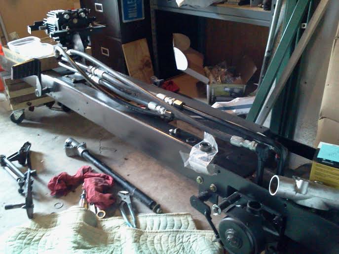

rtfbg 744 #50 Posted July 9, 2014 Thanks guys ... psyco ... I sure wish I had the space, I do have a nice compressor and a gun, but I have zero space to work. Like working in a phone booth!! Rob .. I hear ya ... if I take it easy it's ok, but I keep the nitro patches in my wallet, and pills around my neck, so I'm ready if it starts getting "exciting"!! Anyway, got the hoses installed, and started with the steering. Trying to do all I can before putting the side panels on. My fat hands don't fit in tight spaces!!! 1 Share this post Link to post Share on other sites
