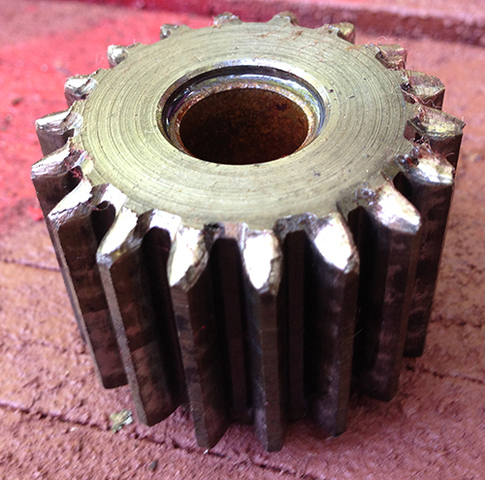

OK, I cracked it open. Probably going to wish I hadn't - but frankly, this isn't all as complicated as I feared.   - This is the reverse idler gear - does it look a bit chewed up to you guys? There are some pretty sharp edges on the top; just looks a little worse for the wear.
groundhog47
:twocents-02cents:  It's a bit gnawed but is supposed to be beveled anyway. You could prob dress the teeth  :handgestures-fingerscrossed:  smoother and get a pass on changing out. I'm curious if maybe detent ball may be missing or undersized in Hi-Lo shift "tube". Seems as if that would allow over travel, but am sure you would notice lack of detent lock when moving L-R.
DuchApl
Thanks, Gerry. I have the Hi-Lo  fork out and there seems to be a rather positive click when I move it up and down manually. I have new detent balls and springs on order, so if they are out of spec, that should cure it. The "L" -shaped shifter connection looks good too - I actually thought the slot might be deformed wider making a longer travel, but it seems ok. Then again, it wouldn't take much, I guess. The only other thing I can think of is the hi/lo shifter fork wasn't seated all the way down, but that really doesn't make much sense.  I'm also going to retrace my steps and go back to Steve's suggestion that the slack may be in the shifter itself - outer holes may be larger than the shaft holes. I'll let you know what I find.
groundhog47
Sounds like you have all bases covered, that is a curious situation though. :handgestures-fingerscrossed: Hope you geter solved. Every time we list a problem and it becomes solved we all benefit from the discovery! :handgestures-salute:

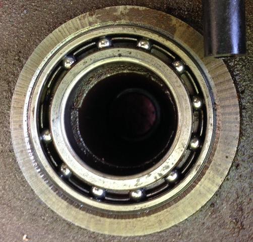

Glad I took this apart. The Imfamous differential bearing was missing a ball. Found it in the case sheared in half.

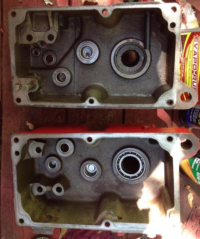

There was also quite a bit of rust above the oil level so I tried Evapo-rust on the inside of the case. Did a nice job - leaves only nice dark gray iron.
Just waiting on a gasket and this puppy is going to live again. As to the original problem... I won't really know until I start re-assembling the tractor again.
