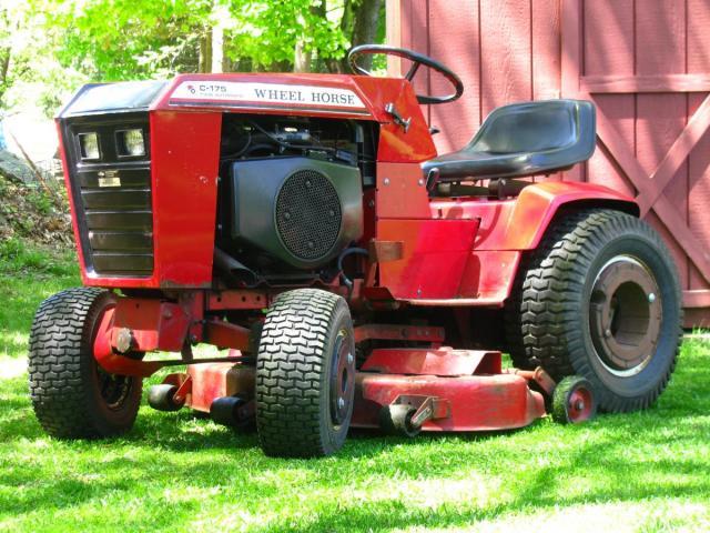

edwroy 138 #1 Posted May 9, 2014 Ebay find - 1983 Wheel Horse C175 twin - advertised as non-running - $ 500.00. Picked it up - hit it with started fluid - turned on the gas valve - started right up. Mowed the lawn with it. No leaks. Needs some maintenance. 5 Share this post Link to post Share on other sites
boovuc 1,090 #2 Posted May 9, 2014 Nice! Pretty nice performance for a non-running tractor! Now ditch the plastic fender for a metal one and have at it! Share this post Link to post Share on other sites

km3h 543 #6 Posted May 9, 2014 Looks to be in great shape. Must have been kept inside. Really good find. Share this post Link to post Share on other sites
Racinbob 11,034 #7 Posted May 9, 2014 That looks sweet! The seller thought it was broke because of the fuel valve being shut? If so. good for you!!! Share this post Link to post Share on other sites
JackC 617 #8 Posted May 9, 2014 Very nice C-175. The plastic fender size and lines were designed to harmonize with the size and lines of the hood. Many prefer the metal fender but from a design balance point of view the scale of the metal fender is small relative to the hood. With the plastic fender, filling the tank requires a long neck on the gas can due to the tall lip of the fender by the tank opening. Great find. 1 Share this post Link to post Share on other sites

Fun Engineer 859 #13 Posted May 9, 2014 We don't find them like that up here in the Rust Belt. If that Fender doesn't have any cracks in it and it's going to be a worker I would remove it to preserve it, otherwise I'd leave it on. it does complete the look. Sent from my tractor seat using Tapatalk 2 1 Share this post Link to post Share on other sites
546cowboy 301 #14 Posted May 9, 2014 Being from Indiana my self, that is one great find in your area. I have gone down to Indy and Terre Haute to get some Horses and they never were in that kind of shape. Most I've got from down there didn't run either. But none were easy fixes like that and I have never seen a plastic seat pan that wasn't cracked and scratched up or faded. You are one lucky Hoosier. Share this post Link to post Share on other sites

Fordiesel69 259 #20 Posted May 12, 2014 That appears to be a series one KT17. If so operate it only on flat ground and add 1/4 qt overfull on the oil and you should be OK. Operating on hills will make your KT17 pop a connecting rod. Share this post Link to post Share on other sites
edwroy 138 #21 Posted May 13, 2014 How can I tell if the engine is a KT17 series one - can I check serial numbers? 1 Share this post Link to post Share on other sites
AMC RULES 37,125 #22 Posted May 13, 2014 (edited) I think I've read, if it ends over three hundred. Post your serial number here. Looks like your picts show a yard custom made for a Series 1. Edited May 13, 2014 by AMC RULES Share this post Link to post Share on other sites
boovuc 1,090 #23 Posted May 13, 2014 The specification number of the Series I KT 17 is "24299 and lower. The full pressurized Series II KT17 spec# is 24300 and higher. Kohler loved to tell the world that their KT was a Series II also by labeling it as such on the outer engine shroud on the fly wheel side which yours isn't. Some replacement engines were not labeled and some folks like to use Series II shrouds on their Series I motors so so it is best to check your Spec Number on the engine tag. Share this post Link to post Share on other sites

edwroy 138 #25 Posted May 14, 2014 Okay - so serial number is 12176393 Specs 24223 Share this post Link to post Share on other sites
