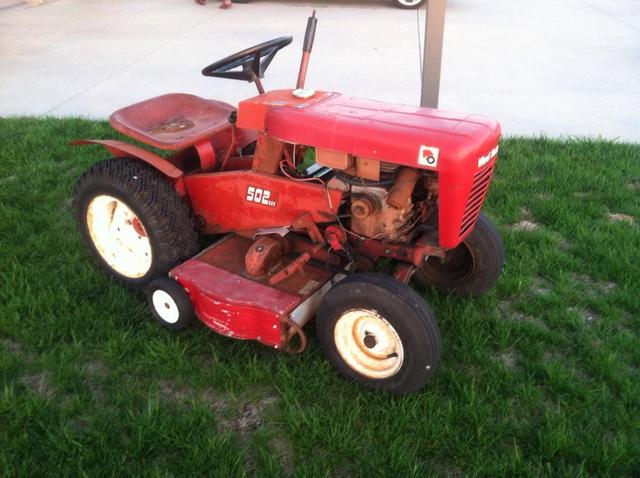

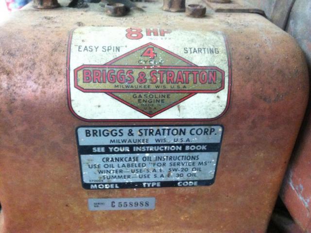

cyclist 2 #1 Posted May 5, 2014 A fine gentleman a couple of miles down the road had 3 for sale in his front yard since last spring. The number kept diminishing from 3 to 2 to just this one last fall. Poor thing sat out there all winter long, but it was the one I had my eye on all along. It reminded me of the one I learned to drive on at my Grandpa's nearly 40 years ago. Pa sold it one day and bought a newer WH. But I always liked that older model better. I road my bicycle past it for a year. The grass is finally growing here and we have the yard all trimmed up and the flowers planted today. We got finished and my 10 year old son and I drove down to take a closer look. I had the itch. He told me all about the history of it and how he came to own 3 WH's. This one was bought with a snow blower, but it quickly sold last spring. There is no battery in it, needs a belt to activate the deck and has had the motor replaced many years before. Like prior to him buying it 15+ years ago. It has a Briggs n Stratton 8 hp. The hood was stretched to accommodate the larger motor, but it was done nicely. He said several collectors had been eying it, I told him I was no collector. I planned to work it. He said he thought it was worth $200, I offered $100 and denied his counter. I walked away with the key, hope she will run. He said it ran for about 30 seconds at a time and would die last year. He took apart the carburetor, found it all bunked up, cleaned it up, but said it never ran after that. So what do you think?? A good buy? Any suggestions on preparations for getting her running? I'm no mechanic, but am mechanically inclined. 2 Share this post Link to post Share on other sites

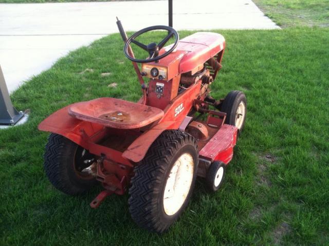

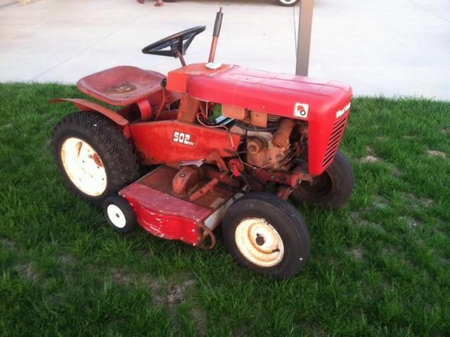

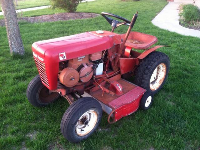

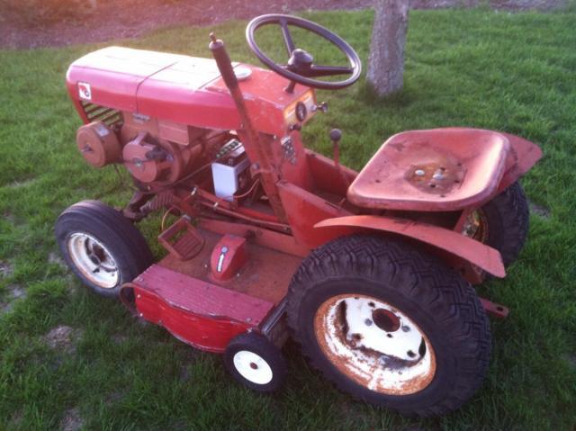

cyclist 2 #13 Posted May 10, 2014 I pulled her home last night, how's she look? Share this post Link to post Share on other sites
cyclist 2 #14 Posted May 10, 2014 I've noticed after just 15 minutes of toying around with it that bearings built in 1962, certainly are durable. I got the idler pulley freed up and spinning like a top. Seems to feel like new and have little play in it. I am going to enjoy tearing her down and cleaning her up. I want to a closer look at the grease points on top of the deck and change all the fluids. I think I'll exchange the battery for a larger 12v that better fits the tray. Share this post Link to post Share on other sites
wallfish 17,464 #15 Posted May 10, 2014 That's a shame someone cut the hood for a larger Briggs engine although I've seen much worse hood chops than that one. An 8 hp Kohler would've fit without modifying the hood. You did very good for what you paid and it should look nice once it's cleaned up a bit. Share this post Link to post Share on other sites
cyclist 2 #16 Posted May 10, 2014 It looks like they would have had to of taken 2 matching hoods to stretch it out. It is a shame though. I like the proportions from a far, but not the fact it was cut. It appears they were also having problems with the original fuel tank in the dash leaking. If I later take that apart, do you think the tank could be resealed effectively? It must have leaking along a seam at the base of dash. Share this post Link to post Share on other sites
