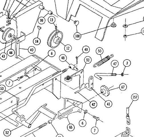

pfrederi

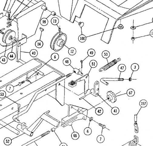

Parking Brake is item 51 on the parts list.

I think I see in that diagram the pieces that are missing. That lever should hold the clutch pedal in and the belts disengaged.

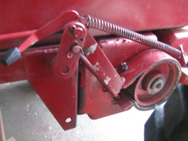

nyquil...got to tell ya...your horse should be like my 857.  Here is couple of pictures...I do not have a parking brake either...nor does it look like one was ever there.  Our tractors should be about the same.  See what you think...I was all over this a few minutes ago.  This is the kind of thing that just does not disappear...the parts would be hanging there...even if they did not work.  See if this looks like yours.  :)  It looks like piece 51 is missing and sets on piece 48 (in the drawing above) and when pushed forward one of the notches hits on the top of the brake shoe...thus locking it brake shoe on the drum.  If so...this is the same piece that is on the 502, 702 etc.  I was able to find this at a show and made a drawing of it.  I needed it for my 502.  Check the drawing...you can make this...or I can look for you at some the swaps coming up and send you one.  Let me know what you think.

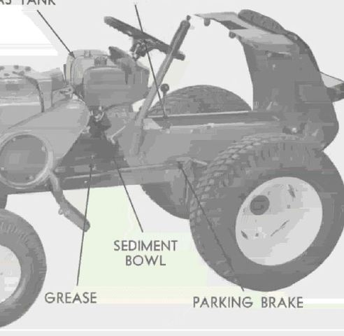

Your setup should be similar to the parking brake assembly from my '68 Commando...
which I've shown here for reference.   :handgestures-thumbsup:

Yes Craig...that is it exactly.  great picture...thanks Craig.  :)  I think Glen Pettite sells the plastic part that goes on the handle.  Notice where the spring is in Craig's picture...I did not have that hole in the piece for the 502 (not needed there...it mounts a little different)...but the hole is there for the spring if that brake piece is not there.

Yep it is just like that stevasaurus. From the pic I am pretty sure this also holds the clutch pedal down and thus keeps the belt disengaged.
Which will fix the multiple problems, IE locking the brake, and locking the belt in the slack position....
