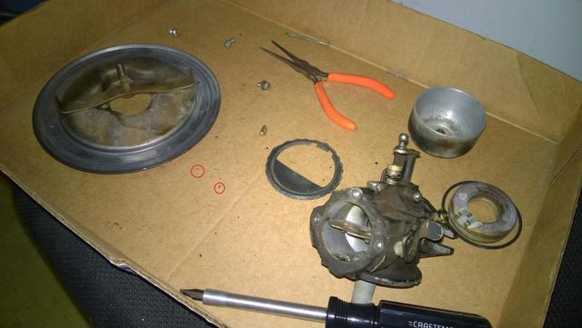

So, I think I have found my problem! :happy-partydance:   Today, I took the carb apart, slowly and kept an eye out for any problems.  I found two quite large pieces of dirt under the float valve sitting in the seat :thingy:  after i removed the float valve. I'm sure that these pieces of dirt were not allowing the valve to close and stop the fuel from flowing, hence my uncontrollable flooding problem.  My float seems to not be rotted thru at all, but, I am not too sure how much more time it has, it seems as if it has seen better days.  I am going to try to find a carb dunk can, and clean the carb, and then replace a few of the parts as I got the kit, and then  :handgestures-fingerscrossed:  and put it all back together and it should work fine, hopefully!  I appreciate you all for your input and ideas though.  :text-thankyouyellow:
In the attached picture, are my two "dirty" culprits.  :laughing-rofl:

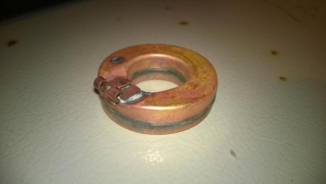

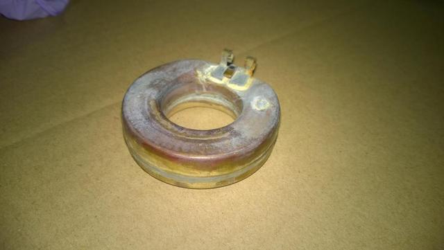

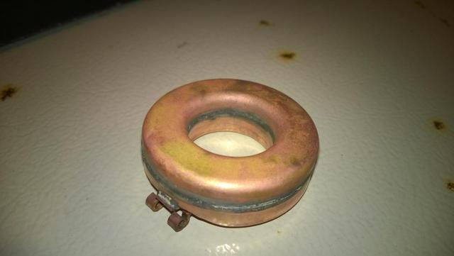

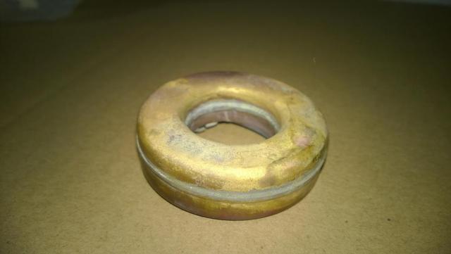

So, I did as you said, and have before and after pics.  Thanks for the idea!  It was only about 10-15 min of brushing. Not sure how much cleaner I could get it though.  And it seems to almost be somewhat copper after cleaning, unless if I scrubbed too hard? Is that possible on a float?  :eusa-think: I've never cleaned one before, but regardless, it does look much much better.
You can click on the pics for better detail.  :handgestures-thumbupright:
Before:
post-12245-0-46292100-1398217662_thumb.j
post-12245-0-77026900-1398217666_thumb.j
After:
post-12245-0-94795000-1398217670_thumb.j
post-12245-0-44052700-1398217676_thumb.j
