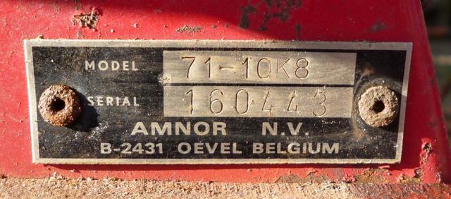

wessex horse 15 #1 Posted April 14, 2014 evening all, finally getting my mower deck sorted, I need a drive belt from the engine to the deck, and it'll probably be wise to renew the spindle drive belt to the blades. I have scrutinised the charts here but can't get my head around the columns of figures. If anyone could give me either a part number or equivalent it'd be a big help. My horse is a Raider 10, id tag reads 71-10K8 160443; its a belgian assembled one. deck is a 36inch rear discharge. many thanks. incidentally my Wheel Horse is proving its worth, well patinated, to put it mildly, my neighbour, who has a new green thing, and being young-ish thinks if it ain't shiny it won't work, was well impressed with the old girl as she screwed her way through the hub deep muck in our wood; even more when I loaded up a big trailer with timber and it made no difference, she just tugged away. cleat tyres though. and itll take a bump, being made of steel instead of plastic. 2 Share this post Link to post Share on other sites
meadowfield 2,650 #2 Posted April 14, 2014 Can't immediately help you on length, though they are long That model number doesn't fit for a Raider 10, it's more like a C-100 or B-100 from 1977.... Share this post Link to post Share on other sites

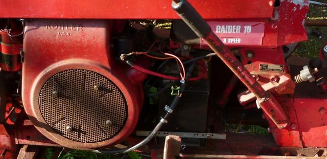

wessex horse 15 #4 Posted April 15, 2014 thats interesting it plainly says Raider10 on the side and its got original decals,as you can see from the "patina" any new paint has been hastily laid on by me. I am intrigued to know what I've got...is it some Belgian miss-mash of mixed bits? Share this post Link to post Share on other sites
meadowfield 2,650 #5 Posted April 15, 2014 (edited) It was definitely assembled in 1977 at the Amnor factory. That model and spec are a B-100, the Amnor factory often made some quirky models. Given that age of components and assembly date made the model, once the tag is removed or changed you can make pretty well any model out of a few common parts.... Edited April 15, 2014 by meadowfield Share this post Link to post Share on other sites
wheeledhorseman 579 #6 Posted April 15, 2014 Having looked through photos of Raider 10s, wouldn't I be right in saying that those decals aren't in the WH factory style and they're two separate decals, not even the same length. I suspect these were added later for some unknown reason. I have a 71-10K8 (71=1977) Amnor assembled tractor and Mark's right in that these were what had previously been a B-800 spec tractor in the US but they were badged and sold in Europe as a C-100 model. Here it is. Andy Share this post Link to post Share on other sites
meadowfield 2,650 #7 Posted April 15, 2014 Andy, I've shipped a few sets of Raider 10 in the split style. I think it worked well for WH in that they just added a 4 or 8 speed decal underneath. Re: the length I think they have been peeled hacked as part of the same resto that sprayed over the kohler decals.... Share this post Link to post Share on other sites
Anglo Traction 761 #8 Posted April 15, 2014 (edited) Your right about the decals Andy, they are the Decals that were also on my 74 Raider/C-120. They had them made in Belgium after WH U.S. stopped producing the proper ones in 72-73 as they went to 'No Names' from then. Re your Tractor Wessex Horse, for a model reputedly built in '77' , it has the Hoodstand and High Fuel Tank of a pre 76 Model. So they must have still been clearing the backlog parts in that year. Oops!, didn't see Mark's post while I was typing mine. Edited April 15, 2014 by Anglo Traction Share this post Link to post Share on other sites

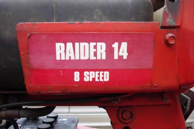

meadowfield 2,650 #10 Posted April 15, 2014 Here's a customer wheel horse from 3 years ago. It was badged raider 14, but the model number was and Raider 12. It was the same split style decal. thanks chaps so what I should be looking for in parts books and manuals is for a C-100? 1976-77? all I need now is a belt and we'll tackle those poxy nettles, so any more definate numbers for a belt please? I also run a merry tiller, and I have lots of belts tat don't fit, could do without that for the wheeler C-100 should get you 99% there, if you get stuck then give us a shout! The info from Garry should be ok, look for the closest length and profile. Mark Share this post Link to post Share on other sites

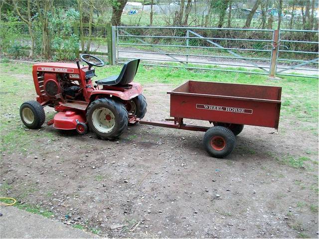

wessex horse 15 #13 Posted April 15, 2014 thanks all. I'll post a pic at the weekend of my horse hauling an impressive load. Doesn't bother me at all its not what it says on the tin, just pleased to have got a good one. Especially as it seems word is getting around about 'proper' Wheelhorsesand the price is creeping up. all I need now is a grader blade or a dozer blade and some wheel weights, I've been looking at various clips and pics here and have an idea for some of my own I got loads of old lead weights........and some brake drums... Share this post Link to post Share on other sites
meadowfield 2,650 #14 Posted April 15, 2014 Hehe, there's a good vid from Robins about home made wheel weights and a dozer blade... Wheel horse with blades on are useful and fun, here's mine in action a few years ago. Share this post Link to post Share on other sites
