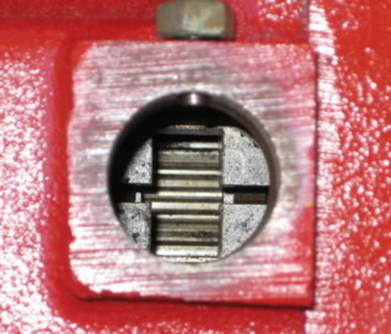

jeff w 7 #1 Posted April 13, 2014 Hello again everyone.Question #1> after finally getting dog point (broken) screw out- wondering about adjusting shifting rails as trans is in 2nd gear? Question #2> Want to run new gear oil when I get ready to go & wondered what weight (80-90W), and the capacity? Further, running new lube for a while should I change again as it is looking crappy? Thanks!! Share this post Link to post Share on other sites
rmaynard 17,527 #2 Posted April 13, 2014 Looking down into the shifter hole, you should see this if the transmission is in neutral. If not, move them with a screwdriver until they look like the above. 80/90 is fine. Book calls for 90/140. If you suspect that there is water in the oil, drain it and fill it with kerosene. Run it around for a few minutes, shifting into all gears, then drain it and refill with gear oil. You will never get it all out unless you crack open the case and wipe it with a rag. Remember to lift the front end of the tractor to get the transmission oil to go past the hump in the bottom of the case. 1 Share this post Link to post Share on other sites
