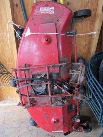

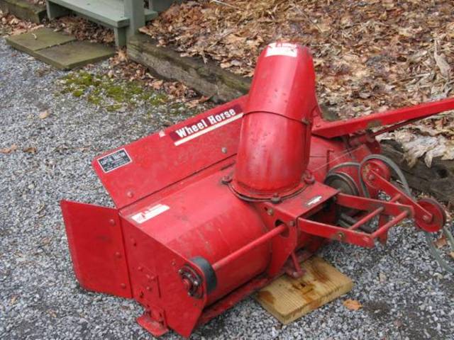

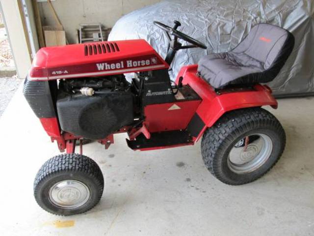

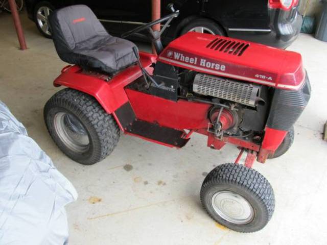

matthon 11 #1 Posted April 9, 2014 (edited) I am looking at a 418-A for sale. It has the Kohler twin with 1650 hours, 48 in deck, a single stage snowblower, chains and wheel weights. It says it includes all manuals and is in good condition. They are asking $1,250. I have no experience with this engine, or what this model came with. Any idea what it might be worth? Edited April 9, 2014 by matthon 3 Share this post Link to post Share on other sites
slammer302 2,156 #2 Posted April 9, 2014 That price is a little high considering it has that many hours this is only my opinion Its not far off though Share this post Link to post Share on other sites
daveoman1966 3,807 #3 Posted April 9, 2014 Deck worth 250 and blower 250...probably, depending on condition of each. That leaves 750 for the tractor. Take it for a 30 minute drive...or enough to get the Eaton trans warmed up to operating temp. Then see if still has lots of pulling power as it should, and test the hyd lift on it too. If the engine doesn't smoke and the hyd trans / lift seems ok... your call. If not, then you may have a bargaing chip or two to negotiate down some. This would be the ID of that tractor: 31-18KE01 1987 418-A Garden Tractor Automatic Kohler M18QS-24510 Share this post Link to post Share on other sites
AMC RULES 37,146 #4 Posted April 9, 2014 (edited) Clean tractor, average price(in my area), high hours. Edited April 9, 2014 by AMC RULES Share this post Link to post Share on other sites
Ken B 3,165 #5 Posted April 9, 2014 Not a bad price, since you say they are asking 1250.00 if you can get him down a tad it would be a great price. It looks to be in pretty nice shape so I'm sure its owner took decent care of the tractor. The full set of hub caps will easily sell for well over a hundred bucks alone on Epay. My 417 has just a tick under 2000 hrs. on it and it runs awesome. Share this post Link to post Share on other sites
rexman72 210 #6 Posted April 9, 2014 1000 bucks i am sure will take it Share this post Link to post Share on other sites
dennist 139 #7 Posted April 9, 2014 As stated above, It appears to have been well taken care of. The attachments look good and clean, without rust and dents. I would want to pay a little less, but I always want to pay less. The 418-A is one of those that kinda gets me to pay a little more depending on cond. If you do get it, IMO you will really be happy with it. A great tractor. Share this post Link to post Share on other sites
