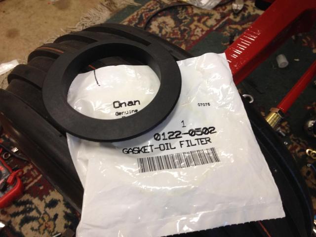

Does your 520 have the rubber air seal around the oil filter? It's a cheap part and it helps airflow to the rear cylinder also.

   I have been skimming through my parts and service manual that came with the 520 and I cant find the part number for the gasket around the oil filter hole. If any one could shed some light on that subject, that would be great. ** Nevermind, I just found your post from last year on this topic**

post-4321-0-04219600-1395544526_thumb.jp
just seen your edit. guess its here for somebody else if needed.......
