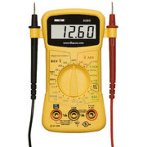

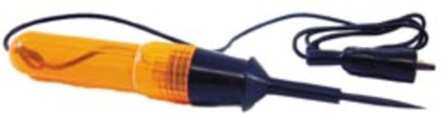

Go to Walmart or some other store and pick up either a cheap meter  post-2221-0-52856300-1393892806.jpg or a test light post-2221-0-95823200-1393892851.jpg
You should be able to spend about $10.00 on a meter or $5.00 on a light. Once you have one of them in hand, it will be a lot easier for us to help you trace the circuits to see where your problem is.
