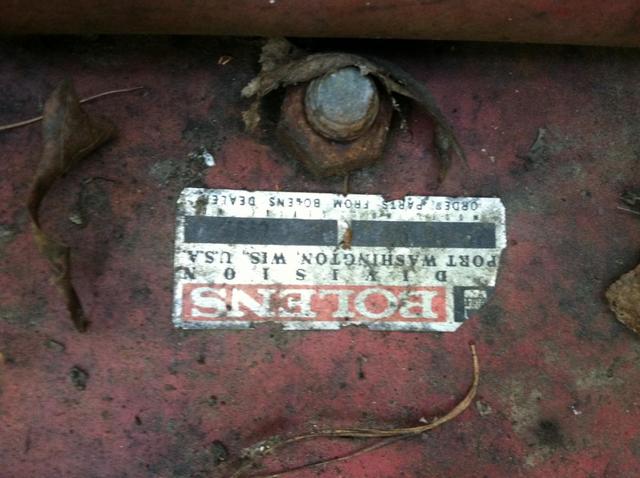

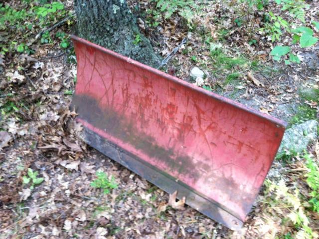

I have a snow plow that came with my 1276 but its not for a wheel horse... its a bolens plow and last time my dad used it he said that to lift it up or turn the blade he had to get off and lift it up or move it by hand... I was wondering if I could customize that plow so I can lift it with the deck lever and tilt it with another lever... Is this possible...
Thanks in advance,
Thanks, Nate

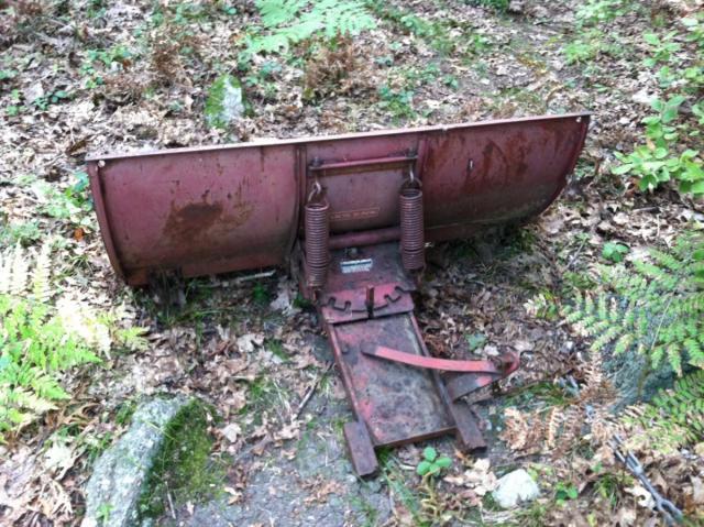

here is one more photo I forgot to upload...
post-12518-0-94527900-1392504001_thumb.j
Kelly
I have owned a few of those plows, I guess any thing is possible with a torch and welder, but it will take some work to make it fit and work as you want,  and your right even around me Bolens stuff is not a hot seller

Nate, looking at that plow you could add two pieces of square tubing off the back similar to a wheel horse plow. Then add the control in a similar manner and you would have a plow. Additionally you could extend the sides a few inches to get more width. When you choose the length you want the plow fully angled and make sure it clears the front tire. Then you would need to fabricate the bracket to attach it to the rear axle.
But unless you get your materials for cheap or free it may be better to do as suggested and wait for one to come up on craigslist. Mine was a hundred and I have seen them go for seventy-five. Just make sure it comes with the plow bracket. Then sell the bolens plow even if you only get 40 or 50 for it and you will be ahead.
