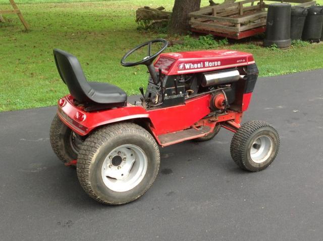

papaglide 542 #13 Posted February 12, 2014 I used coke and aluminum foil on the muffler guard on my 417-A. It cleaned up the rust awesome BUT left tints of color similar to oil laying on water on it. Can't really see it in this picture but it's there. Not sure what to do about that... Share this post Link to post Share on other sites
Jrblanke 885 #14 Posted February 12, 2014 That 417A looks good! Van, I completely forgot about Evap-o-rust. We used that stuff at work. In fact, I made this fun little picture to send to some people here at the office using my avatar picture. I can't believe I forgot about evaporust. 3 Share this post Link to post Share on other sites
Wheel-N-It 2,971 #15 Posted February 12, 2014 James thats one of the funniest things I've seen here in the past two years! Papa Mike, I think what you got looks good !!! Share this post Link to post Share on other sites
