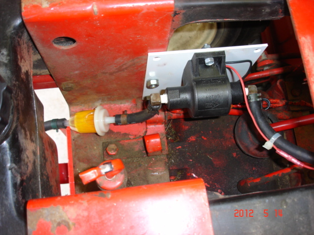

JC 1965 1,532 #7 Posted February 1, 2014 You don't need to install a Tee on the outlet side of the pump. I have the same pump on my C-121. I pulled the seat pan and mounted the pump down in the hollowed out space on top of the trans. That puts the pump at about the same level as the gas shutoff valve on the bottom of the tractor gas tank. That way the pump gets gravity fed gas from the gas tank and pushes it on to the carb. Also in that position the pump is in line with the fuel line that is routed through.there. If you have an older tractor with the gas tank under the hood you can mount the pump on the dash tower like mike ( squonk ) did in the pics. Hope this helps. I suggest wiring the pump through a relay like Mike did. Share this post Link to post Share on other sites

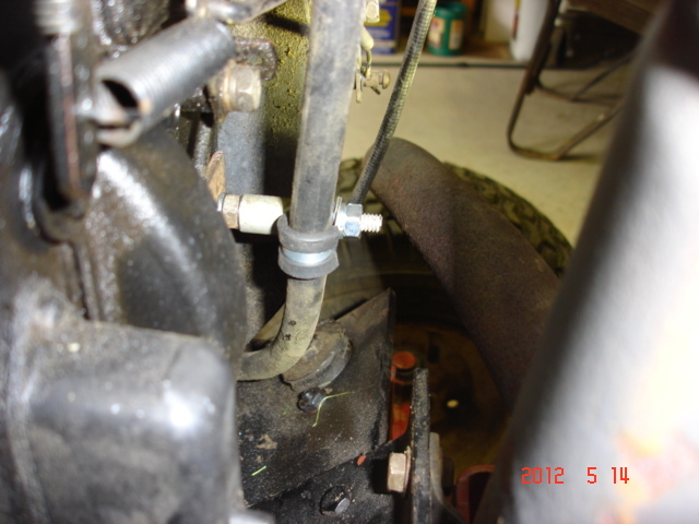

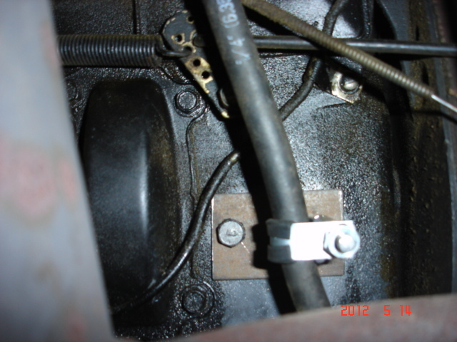

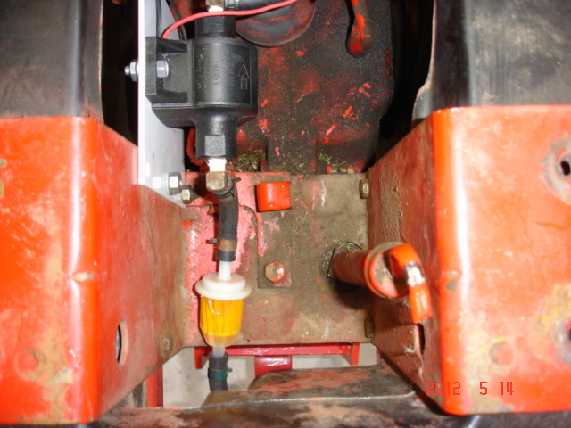

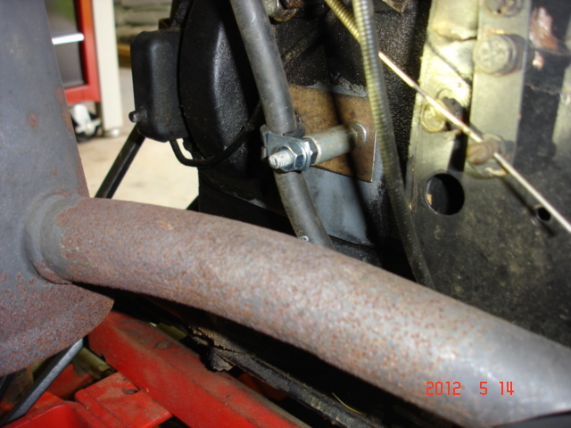

Marv 952 #8 Posted February 2, 2014 Here is the way I did it. Marvin Share this post Link to post Share on other sites
