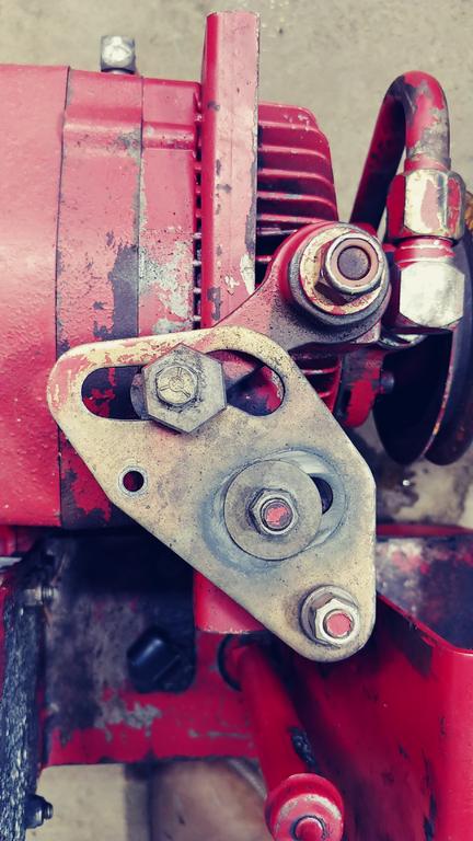

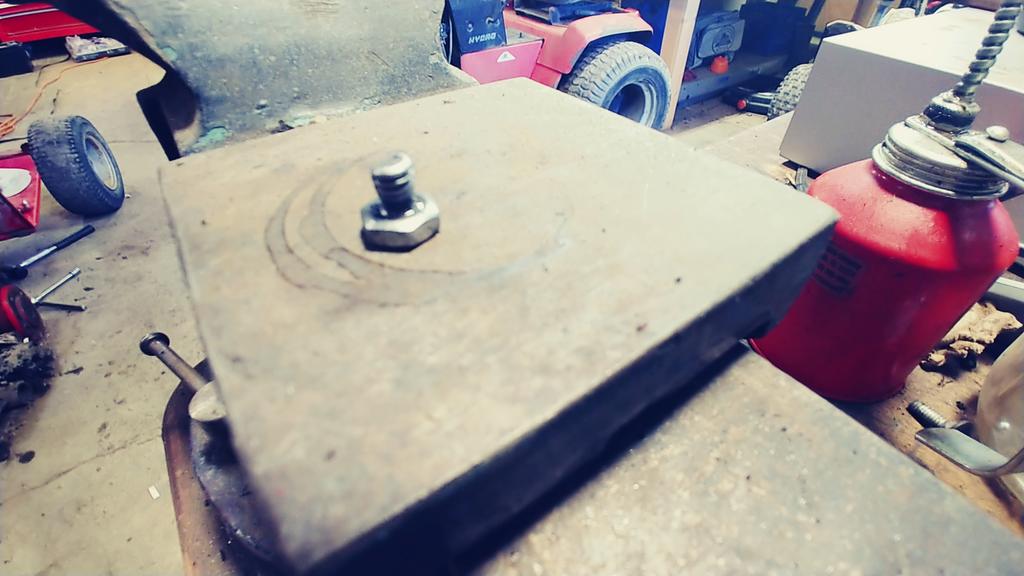

I have the same problem. When I spin the fan by hand you can hear something rattle inside. I bought another rear end for it and it turns out that a 520 uses a different style.
Ralph S
This is in the 518
Ralph S
Ralph S

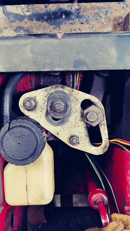

The second picture is what I believe to be a 520. There are no markings on it
Ralph S
1 minute ago, Ralph S said:
520 spare
Ralph S
Notice the pivot point is in different positions.

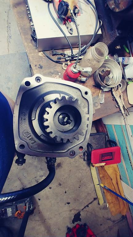

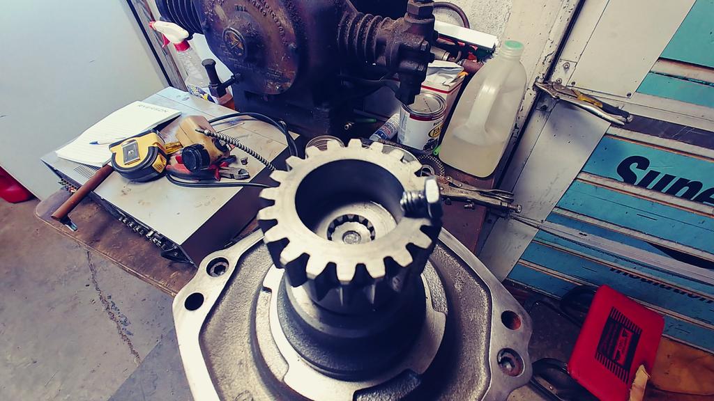

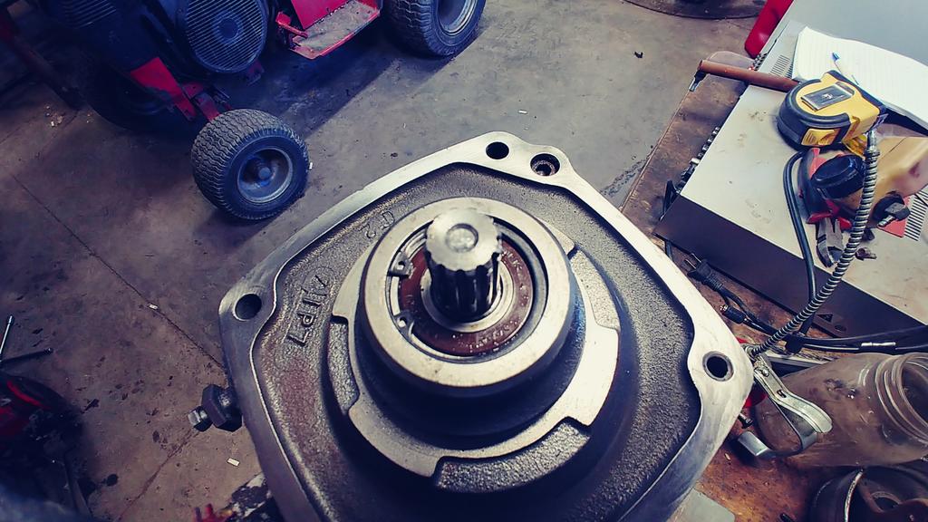

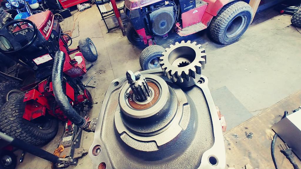

On 3/21/2019 at 10:21 AM, Mike in Fort Erie Ontario said:
I ended up fixing it by buying another wheelhorse.  I bought a 520 and got a descent deal on it and I still have the 518 as a parts machine.
I suspect it is something internal and apparently it happens a lot with that rear end.  The 520 rear end is a bigger pump that is easier to service and it has a filter.
Probably not much help to you sorry.  I was weird when it went.  No warning, it just quit.
20190323_100831.jpg.ba48a0bfc3b2c2dd1d40833e0bfb3bbb.jpg20190323_100855_HDR.jpg.1c95db839f0cfcf5691a211e90b2b1f0.jpg20190323_100728.jpg.525e5b6077083fe1eba804f8f2e35906.jpg20190323_100756_HDR.jpg.65fb7ff0cc1e87e4bd7467e8fbab299e.jpg20190323_100805.jpg.19e9373ba353fccae98bfc3ec3cc8711.jpg
Ralph S
Those photos show what I found on mine. a 40 cent bolt snapped and let the gear slip off the end of the pump shaft.
