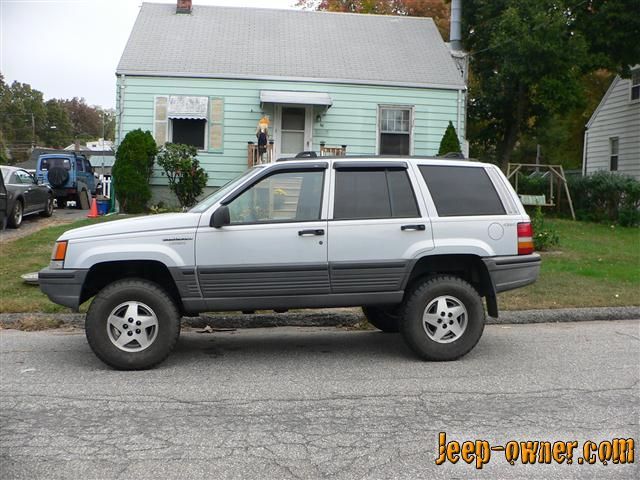

redidbull 54 #16 Posted January 29, 2014 http://www.jeep-owner.com http://www.cherokeeforum.com are 2 sites I am on. I have a 95 GC with the 5.2L. There are a few 5.9L forums around too. Seems like those who have that beast really get into it. Jim Share this post Link to post Share on other sites
RMCIII 838 #17 Posted February 1, 2014 Update... Just something to share with the group. Not sure if any member has a 5.9, but if you do, I can now relate as to why they are such a delicacy that many Jeep fans would love to have, if they could find one close to their homestead, or has not been trashed. I do not consider myself a auto"expert" but I have had quite a few gems in my time so far. < Plan on having a few more also. I am so impressed with this SUV, I have already started to look for another one. With less than 14,000 ever made, it makes it a small task to find one with low miles, not rotted out, accessories still working, All Time 4 wheel drive not butchered, ect.... So, if anyone has one to sell, or knows someone that has a well kept 5.9 for sale, let me know. I would be interested in possibly purchasing it. Now the good stuff....With a little over 130k miles on the clock, I was very concerned about the engine, transmission, All Time 4 wheel drive lasting much more than 10k miles of my driving before I would need to d some rebuilding. Well, after putting on a little more than 1k miles so far, I can tell this Jeep was taken care of. My investment was $500.00. That consisted of (3) Oil changes and (2) Engine flushes. Head gaskets, new platinum plugs, wires, Differential fluids changed, transfer case topped off, fluid was still a modest pink which told me the previous owner had done a recent change of the fluid. I still need to place some quality shocks on the SUV, a few front end bushing, and eventually replace the steering gear box.< Not a big investment. The biggest is the box at $129.00 on ebay... So, what did I get, with my $500.00 invested into the purchase price? A BIG TIME SLEEPER, that has a modest rumble while sitting at a light, but ROARS to life when the accelerator pedal is depressed. The look on unsuspecting 4-Matic Mercedes owners as they eventually realize their efforts of cutting me off before the road merges is in vain. The bewildered look of x5 owners when they are shocked to see a "Jeep" edging them out on the express lanes under acceleration while pulling away from a toll booth... I could go on... If there are Jeep owners in here who have not heard of a 5.9, but see one for sale at sometime, do yourself a favor, and at least look at it, drive it, you may be surprised. That 1998 Jeep was the fastest SUV in 1998. Motor Trend clocked a 0-60 in 6.8, I have seen that the rest say 7.1, and even found 1 report that lists it at a 6.5. It was not until 2006, when the Hemi Jeep Cherokee was released, that the 5.9 was topped. < With an intake, some head work, headers, and a reprogramming, whala the 5.9 is right there with the Hemi for pennies compared to what an 06 owner had to pay. Don't get me wrong, it is not the ultimate SUV by any means. What I am saying is, for $4k, one can have a very comfortable, reliable, capable, dependable, winter means of transportation that will hang with many new SUV's performance wise. Be capable of towing 5500lbs. and you won't even think twice about how deep the snow is or how rough the terrain is. Remember, before any Jeep bears the brand Jeep, it has to pass the Jeep course. Only in a Jeep. Just my I will get off my now! Share this post Link to post Share on other sites
redidbull 54 #18 Posted February 1, 2014 That is cool! The 5.2L I have is also quite the sleeper. Mine has a 3.5" lift so it is not as "predictable" at speed and I have little seat time. It is my Wife's winter car to replace Her 02 Mustang GT. I got this for $700. Has 150K on it. PO thought the trans was bad but it was a bad u-joint. I have a 242 transfer case I got for $50 to replace the full time 249. Jim 1 Share this post Link to post Share on other sites
