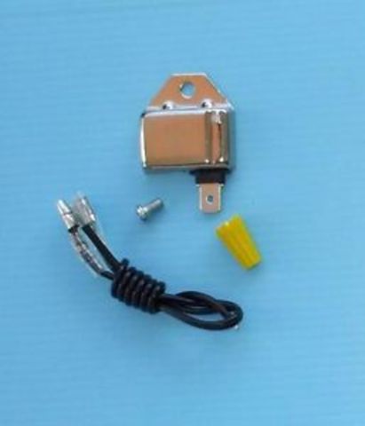

is the little module silver?, i will say hi in the euro section
wheeledhorseman
Sounds like you've found it but to be certain it looks like this.
It basically replaces traditional points hence it's earthed through the case and the other wire goes to the primary coil of the magneto under the flywheel. So if a tacho like the one in the other thread is happy with this type of ignition then my guess would be that it would take the pulse from this wire.
For possible future reference - Kawasaki used two different trigger modules on their range of mower engines. They are distiguishable by the spade connector either being on the right or on the left and are not interchangeable (I guess the timing is different). The Kawaski part is expensive but I got the OEM product by Bosch from an ebayer in Thailand for a fraction of the cost.
Keep us posted on progress with the tacho and any other products suitable for a single cylinder ignition system you come across.

Yes that is exactly what i was thinking of!
so would i just tap into the black wire with the right taco gauge input wire
