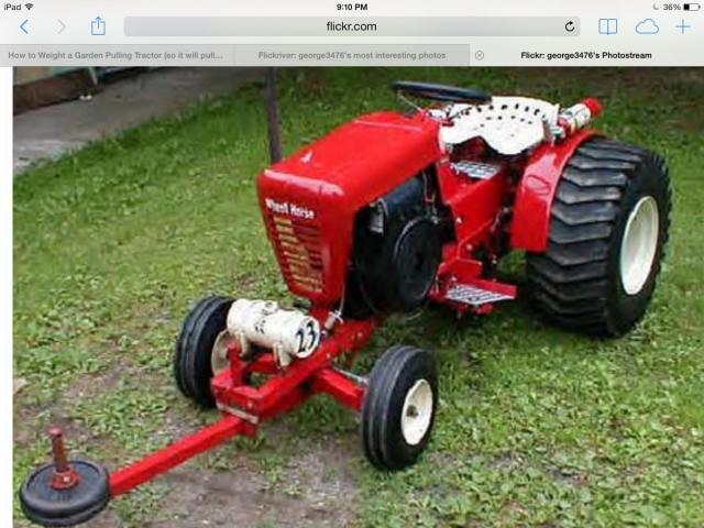

dagwoodz 1 #19 Posted March 12, 2014 Hope to look alot like this when done. Share this post Link to post Share on other sites
chris11 184 #20 Posted March 12, 2014 Post the build here. Share this post Link to post Share on other sites

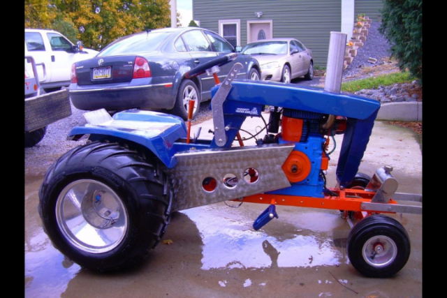

baerpath 517 #24 Posted March 14, 2014 (edited) You'll need longer tie rods, they'll angle back some. Also double up the front mount to take the stress of a full drop when weighted Check your rules that blue one wouldn't be legal here to pull. It would have to be setup to keep you foot from hitting the front of the tire Edited March 14, 2014 by baerpath Share this post Link to post Share on other sites
dagwoodz 1 #25 Posted March 14, 2014 Will do fender ext like this. Sent from my iPod touch using Tapatalk Share this post Link to post Share on other sites
