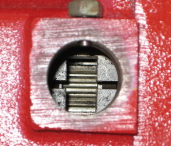

stevasaurus 22,878 #8 Posted January 16, 2014 (edited) The first thing to do is lift up the boot on the shifter. Just in front of the shifter is a dog point set screw with a lock nut on it. loosen the lock nut and, with an Allen wrench, take out the set screw. Lift out the shifter and look in the hole. If it is in neutral, you should see the 2 shift forks form a square in the center of the hole. If you do not see the square, with a large screw driver, try to pry the forks (one at a time) so you get the square. Let us know what you see when you first look into the hole. By the sound of it, the shift fork toward the front of the tractor, which is your 1st and reverse gears, may be centered. The fork toward the rear of your tractor, which is your 2nd and 3rd gears, may be stuck to the right. Regardless, try to center the forks. If you can center the forks, you are in neutral. If you can get into neutral, then try to move each fork (one at a time) from side to side...coming back to neutral before moving the other fork. You can put the rear end up on blocks to do this, so you do not have to drive it. If everything works up to this point...look at your shifter. It should have the ball that the set screw goes into and a shaft below that with a small ball on the end. If all is good...put it back together and check it out. The thinking here is...your shifter is sitting in the 1st and reverse gear fork, while your other fork is locked into 3rd gear. It was binding up when you had both forks in a gear at the same time. Lining both forks in the neutral position and re-inserting the shifter should fix your problem if the shifter is OK. Remember that you have to come to a complete stop when you shift gears. The howling noise you have is a concern. I know you changed the oil, and running it on blocks may reduce the noise after the oil has had time to do it's thing. More likely, you have some worn bearings, in which case you will need to drop the trans and open it up and replace any bad bearings and all the seals. We will see. BTW...the trans is easy to fix if you have to open it up. Edited January 16, 2014 by stevasaurus 1 Share this post Link to post Share on other sites

rmaynard 15,610 #10 Posted January 17, 2014 Take a look at this picture. When you have the shifter removed, looking down into the transmission, this is what the shifter forks should look like in neutral. 2 Share this post Link to post Share on other sites
wheelhorse66 10 #11 Posted January 17, 2014 OK thank you I will check into this tomorrow and let yaw know if everything looks good or not 1 Share this post Link to post Share on other sites
wheelhorse66 10 #12 Posted January 20, 2014 well took a look into the transaxle today,and the shifter forks were out of line,i lined them back up and it shifts fine now, thanks for the help. 2 Share this post Link to post Share on other sites
