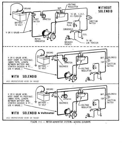

factory wiring diagram wont help, because i have done away with the ammeter and added a starter solenoid. what is confusing me is where to wire all this field and armiture stuff, also the voltage regulator has three terminals, an A, F, and batt, not sure what to do with any of them to get it to charge. was hoping someone with antique electrical systems could point me in the right direction. thanks again yall. the girlfriend is here, ill have her show me how to show a pic. hahaha, she just pointed out, theres a pic of me on the tractor right next to the name.

I don't know if this helps, but here is a diagram that is modified to show various configurations. First is with ammeter, and no solenoid. Second is with ammeter and solenoid, and the third is with VOLTMETER, and solenoid.

The voltmeter should be powered by key-on source so it's not constantly "hot".
It wouldn't hurt to protect that circuit with a 5 or 7.5 amp fuse either.
Modified schematic:
rmaynard
Good call Terry. I copied that drawing from another forum some time ago, and I remember now a discussion about the same thing.
