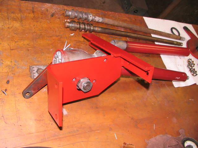

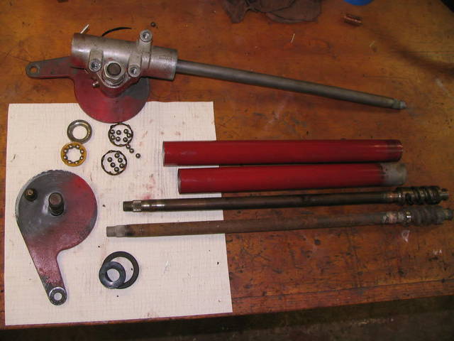

Heres a pic of the shafts/tubes and the bearings. The ball bearing are held in a plastic "cage" and the plastic was badly distorted and would no way hold the balls, the kit has the new plastic cages and new balls and 2 new cups.

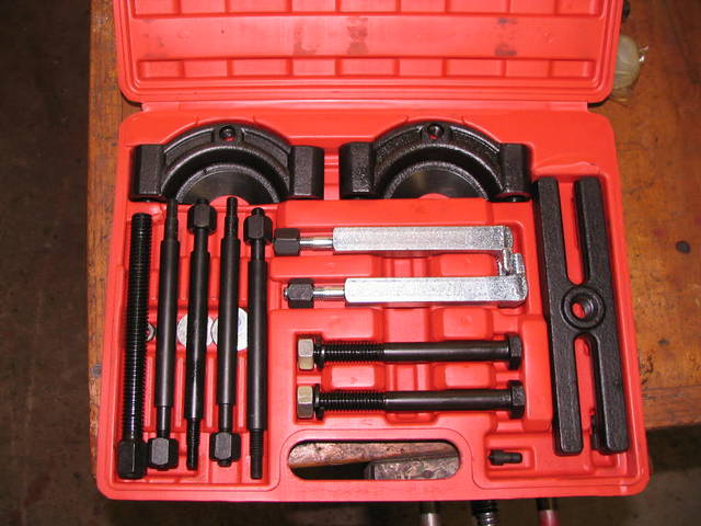

Pulling the wheel - Do not hammer on the shaft like in other situations, this puts force in that very area that is already the weak point on this system - the bottom of the aluminum housing. I use a puller commonly called a "clamshell puller" (probably not the real term, see pic below, thats a HF set about $20-25) besides most pullers wont even fit around the wheel anyway - I did use some light blows to "shock" to help break the bond - used generous amounts of Kroil too. Even with all that, a wheel may just not come loose and drastic measures like Marv had to resort to be required. From the looks of mine, I didnt think I had a prayer of getting it off, bad rusted, but came pretty easily.

The kit I got was for a Cub (here again it seems the housings are alike) from
www.factorydirectmowerparts.com
1 of IH-71930-C91 - Cub Cadet - Kit, Ball Cup @$10.86ea.

OK, an update here ---
In having to change out the steering tube, I noticed that it didnt seem to be an especially good fit, so sure enough after getting it installed and making a couple rounds around the yard it was really loose - tractor sure did steer easily though! After reading Marvins post about him removing his column without removing the weldment, and not liking the loose tube on the steering, I decided to take a look at Marvs approach to removing it -- and sure enough it was quite a bit easier to do it this way (is still a bit of a pill though) I must say it helped to have this area cleaned this time around and could see better about approaching this method.
Remove the steering link, and the 3 bolts that hold the column (this is the awkward part - and then replacing them) and the column drops out the bottom (Obviously you have removed the steering wheel!) This is really not that big a job and servicing the Ross housing with the rebuild bearing kit and giving the unit a good inspection is a prudent thing to do.
