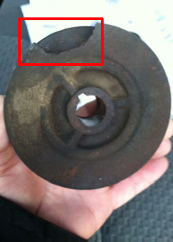

pezsox
had a piece break on a 1611 trasmission pulley for my RJ I am refurbishing. Is there any way to weld it, or should I go straight to the classifieds and start begging? haha
Don1977
You can braze it back together if you have the piece that broke out. Should be able  to fine a used one.
pezsox
I do have the piece. I am not a welder so I didnt know if it should be something I should even take somewhere. Thanks. hopefully someone has one, I dont see any on ebay right now and not entirely sure where else to go.
WH nut
Its cast so you have to know what you are doing if you want it to last
Find a good welding shop. I have a friend who fixes stuff like that all the time. If you were close I could fix you up
