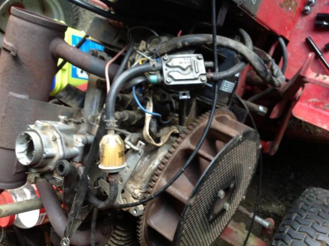

My 416-8 starts, runs and dies after a few minutes. It has been progressively worse over 4 days (not running every day). It would start and run for a half hour or so, then just lose rpm and die. I'd give it a short rest then it would start right up and run. The intervals of running/dying have been  getting shorter. The last time I tried, it would run about 10 mins. and die, and would not start back up. I think carburetor, any clues/suggestions?

Be sure that the vent on the gas cap is not clogged.
Sparky
Before you rip into the carb, start back at the fuel tank. The tank needs to be vented to work properly so try running it with the fuel cap loose. If thats not it then maybe the fuel shutoff at the tank is the problem. It has a small mesh filter screen that can get clogged up with crap, might be time to swap it out. Do you have a fuel filter? How long has it been in service?
It could be the carb still but I would start with these other items first.
Mike..........

The see thru fuel filter is full of gas, but I noticed at one time the filter was almost dry. I'll try all the "easy" fixes first. The fuel hose coming out of the tank looks cracked, but not leaking.

Martin
if the fuel system checks out ok........
ignition could be giving you problems, immediately when it stops check for spark. older ignition components can be unreliable. not saying thats the answer but would be the next step if you can't find the issue........

it won't start at all now, unless I spray starter fluid into the carb, As soon as it uses the fluid it dies. The foam filter was pretty dirty, not oil soaked. I blew both the foam and paper out w/ compressed air. I bet it's time to pull the carb, what do you think? I checked the fuel pump, it's working.

Martin
Sounds like the ignition is good then. I think you have a blockage in the fuel system somewhere. The carbs are easy to check for junk in the bowl, if you are careful removing the top of the carb, the gasket could be saved.
Take a look at my 416 adventures thread, I had fuel issues and managed to clean out the carb with it still on the engine.

WH nut
I would pull the fuel line off the outlet of the fuel pump before I start ripping anything apart

I called the previous owner about the problem, he told me to change the inline fuel filter. I blew though the old one and it seemed clear, but the new filter fixed it.

Ken B
Now I'd give your fuel tank a good cleaning and replace the fuel lines if they haven't ever been done....

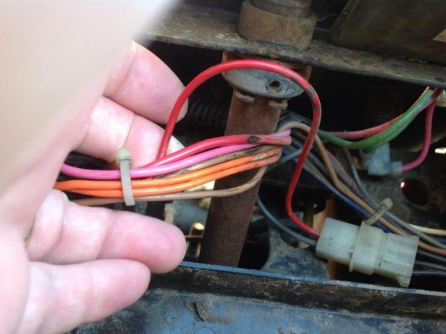

dennist
post-3300-0-57452800-1386086027_thumb.jp
Any above options are great, I tried them over and over. My worker 416-8 made me pull my hair out, it may not turn out to be any of the above issues, yet any one of them could make your problem happen.
I got pretty good at tearing apart all tin, exhaust, intake, carb, replacing fuel lines, pump and filter, removing/cleaning tank, new intake gaskets, then started with electronics...key switch, coil/plugs/wires, ignition module, trigger, jumped every safety switch, etc. Each and every time it would start and I swear it sounded better and ran smoother, but when I would get on it and drive for a few minutes it ran terrible and would die out. Some times it would smoke like a train and other times just seem like it was going to blow on me, but every time after sitting it would start and run smooth....common sense was telling me one thing, but the thought of running over it with a dozer was really looking good to me, And I mean it!
I had it with that darn Onan and finally felt like others on here feel about them, but I could not walk away and let it win me, I atleast wanted to tear it apart to see what was making it run that way. All the wires looked fine, compression was around 115psi on both sides. Finally looking in the same places as earlier right behind the upper steering shaft I pulled the wires completely out just to reassure myself that it had nothing to do with those and......
Lets just say "I" personally can not put the blame on those darn Onans, atleast not this time, although every time someone talks negative about an Onan I somehow link the engine with the non engine tractor issues. Good luck and keep the keys out of the dozers until you get it fixed!

WH nut
He said a fuel filter took care of it, but you did have your hands full dennist, good find
