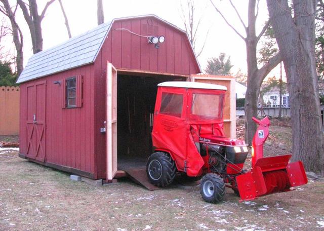

Mine backs up the ramps into the same size door opening no probs at all.
post-3498-0-73066100-1384644614_thumb.jp

Looks like your not hooking up a yellow strobe light on your tractor are you, Craig?
